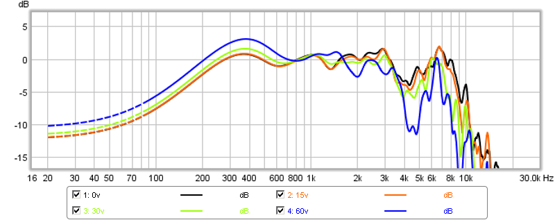

During same measurement set somewhat hasty vertical response measurements were taken; horizontal reference, and 15 degree intervals above horizontal plane. They reveal CBT behavior of array. Array was stationary for measurements with microphone moved; windowing was 6ms. Results suggest array may be used with major axis in horizontal plane instead of vertical plane; I listened to pair this way too. Also with one vertical and one horizontal. Imaging remains very stable in all cases.
Overlays of frequency response for vertical measurements, 6ms windows, and no smoothing:
Vertical coverage across 120 degrees given symmetry. I am certain that MBL speakers and German Physiks speakers do not do this.

Barleywater, your speaker doesn't behave well horizontally, actually it is rather bad. Vertically it is quite good. But it is diffucult to say because I can't see the angles that you used - up to 180¤ ?
Omnis are different totally. To be able to call a speaker omni it should have even radiation (+- 5dB) at least up to 10kHz horizontally 0-180¤ or at least 120¤. But there is no spesific criteria about that.
