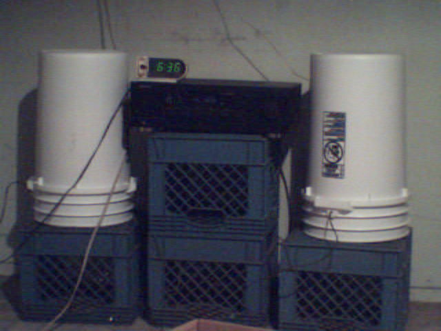

Here's mine ........
Are you serious? Where do you put the drivers (transducers)?

They're in the tops (bottoms(facing the ceiling)) of the cans.Are you serious? Where do you put the drivers (transducers)?
