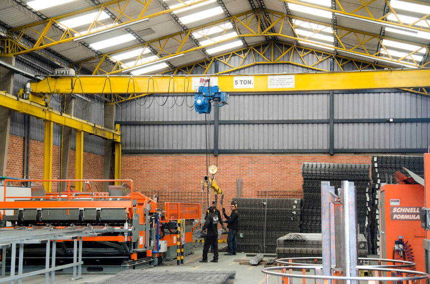

In Engineering we call it "puente grúa", literally "bridge-crane", not sure about the English word but that gives you an idea.
