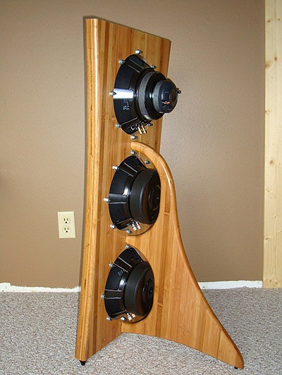

Over time people seem to prefer the castle version of these bipoles:
https://www.diyaudio.com/community/threads/microtower-bipolar-ml-tl-for-chr-70-or-el70.148901/
