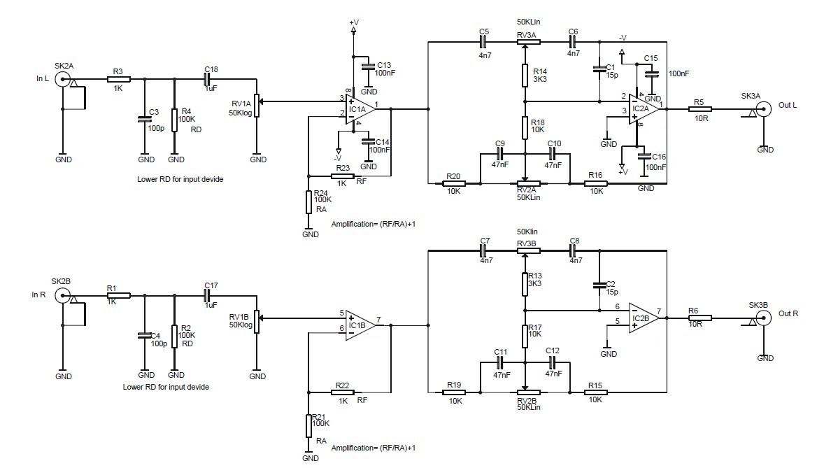

Here are the two stages.
"The volume control uses a linear pot and a modified version of Project 01 'Better Volume Control' to obtain a log response."

Yep, I did the same thing on my last build.
The ESP preamp I'm currently building, however, is logarithmic using a linear pot.

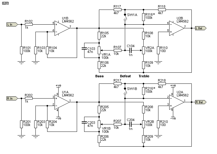

Notice the tone controls shown there use linear pots but those are NFB/active tone controls, that was cleared before.

The tone circuit could easily be scaled to accept the standard 10k lin pots without presenting a unduly load to the opamps.

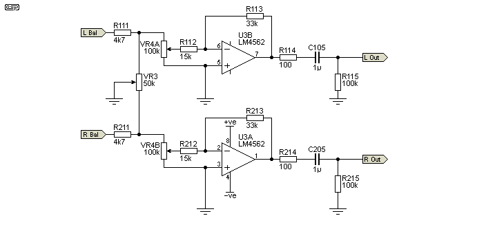

In ESP's preamp shown above the loading resistor is hidden in plain sight:
Volume control Vr4a is 100k, next stage impedance is 15k.
Because it is an inverting OpAmp
That "100k" volume control is being fed through a 4k7 resistor.
In a standard design , using a 100k Log pot, typically feeding a 220k to 1M next stage, the "rule of thumb" applies perfectly.
Drive always sees 100k, or to be more precise, when "on 10" it sees next stage impedance in parallel.
Since conventional wisdom expects, say, 200k to 1M there, no big deal .
Here it does NOT, quite the opposite:
* Those 4k7 feed a pot which varies in impedance, from 100k when "set to 1" to 13k when "on 10"
Gross.
Also: next stage gain varies a lot.
  • pot set low: 33k/15k=2.2X
  • Pot set halfway: 0.49X
An unintended 4:1 gain variation.
Gross.

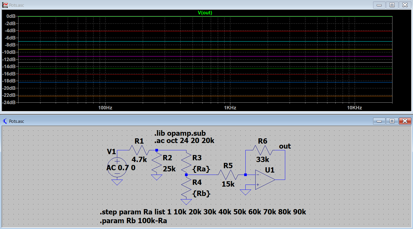

I don't really see the problem with this design. As I said above, that stage is in fact driven by a LM4562 from the previous stage shown in fig. 1., so no need to add any extra opamps, the 4k7 resistor is required for the balance control and in simulation the gain adjustment looks perfectly fine without buffering the pot, you get around -11 dB with the pot in the middle position and a smooth taper towards the extremes, see attached. What's wrong with that?

1) I am not worried by this particular preamp which is just one example but of the generalized (and incorrect) idea that you can happily replace a Log pot by this kludge with no consequences.
The main problem.being the 6:1 to 10:1 pot impedance variation. Gross.
TONS of classic designs in the last 60 years where you can NOT just replace a true Log pot with a "simulated" one.
2) funny but you are confirming what I say 😎
"No need to add an Op Amp"?
Of course, you already used one 😄
How does that contradict me? 🤔
