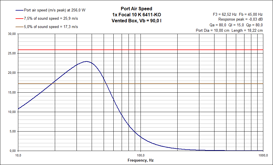

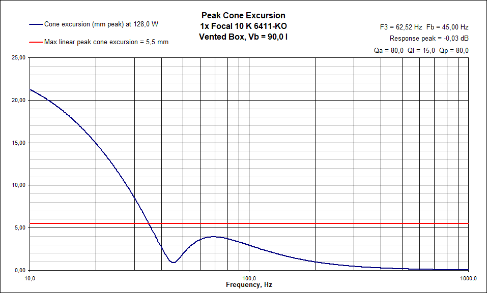

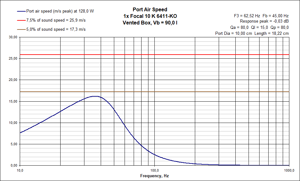

Unibox simulation, 128 and 256W, same 90L box with 45Hz tuning, dual 10 cm ports, T/S parameters from mfg.

That's because the OP wants to use a 19 cm diameter port, using the manufacturer suggested box and tuning (90L 45Hz). The choice of the diameter of the port depends heavily on the SPL the OP wants, something that is limited by the x-max of the driver.
I did a simulation with Unibox, and the box/alignment chosen results in the driver hitting the xmax at:
with 32W, 26Hz with max SPL 113.6 dB
with 64W, 31Hz with max SPL 116.6 dB
with 128W, 35Hz with max SPL 119.6 dB
with 256W, 70Hz with max SPL 122.6 dB
With 32W a single 10 cm tube is perfectly fine, for 64 and 128W dual 10 cm tubes are needed, even for the last case dual 10 cm tubes can be used, but I'd avoid such high power as it will destroy the driver at low frequencies despite what the mfg is saying (not enough x-max).
With 128W Unibox calculates a 8 mm cone excursion. The max cone excursion is not stated in the specs, but can be roughly this value. I'd build the speaker with dual 10 cm tubes. The calculated length is 18 cm, I find that the real length is always lower than calculated, just measure the tuning.
As a final note, forget about calculators and use a simulator.
Ralf
Note that Unibox calculate with the given T/S parameters a sensitivity of just 100.5db/2.83V/m .
