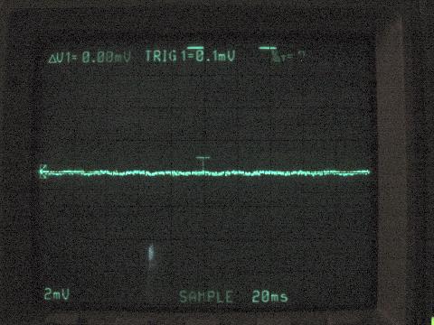

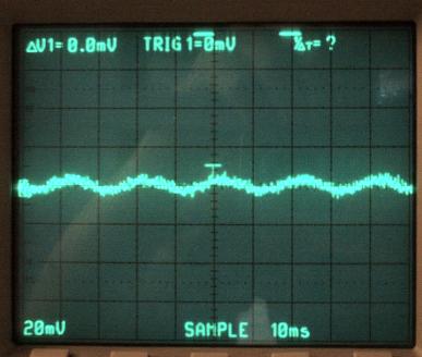

Here are some "measurements" I made with my scope, O think there's much noise on it, is this normal?
1st picture, nothing connected to the scope (no probe)

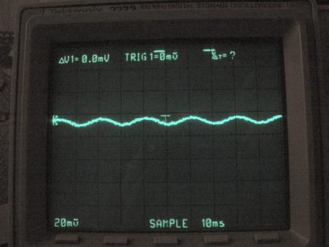

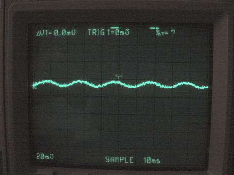

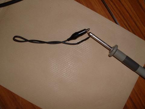

2nd picture, only a 10:1 probe connected on the scope, but not connected to any circuit.
The probe's tip is directly connected to the ground wire of the probe
You can see some 50Hz and HF
Note1: the amplitude of the 50Hz varries when I place the probe elsewhere
Note2: all the measurements have been made in storage mode, otherwise the camera would only take the spot and not the full screen

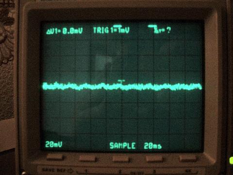

RFI?
Do you have any high pass filters that can be set?
It looks like the scope's sensitivity is set to maximum?
I have a 100 Mhz Hewlett Packard 'scope that does
have a visible internal noise floor with the input set
to the lowest range. I think that's normal.
What do you mean by RFI?
Yes the scope is set to its maximum sensitivity.
No I don't have any HP here, but I could build one it needed.
I didn't manage to measure the noise's frequency, since I can't get my scope to trigger on the signal 🙁
First of all: You won't hear this noise anyway, so why do you care ? :devilr:
2nd (and serious) try:

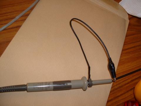

1.) The loop that you form with the ground wire will be able to pick up some noise and RF. If you a curious enough you might connect a shorted BNC to the input and see if there is an improvement.
2.) This small amount of noise isn't that bad at all with the scope set to its maximum sensitivity.

The thing is that you have an environment with RFI noise and you cable picks it up. What happens if your short the inputs of the oscilloscope? Completely silent or still noise?
Don't forget that your scope also has digital noise with can be rather high. I used an old Tek 100 MSp scope with noise of 2-5 levels (of 256)!
Do you have your scope plugged in in an earthed mains outlet?

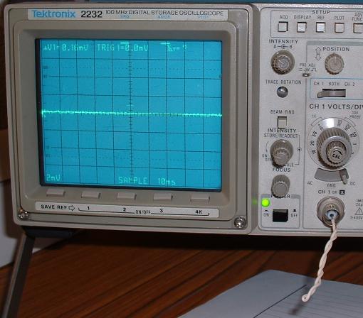

Here it is with the input shorted
No noise, the same as when no probe is connected to the input.
But it's very sensitive. If the wire isn't very closely twisted, there's 50Hz+HF
Yes, the scope is earthed
Borrow someone else's 10x and see if the results are the same. I wonder if the shield in your probe has gone funny. This is a LOT more noise than I see with mine- on the 1 mV scale with the ground clip attached to the probe tip, I get an absolutely flat line.
