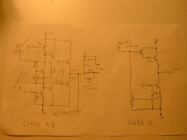

one thing is saying that the bias of the transistors are highly dependent on each other. This is true. Another thing is saying the bias is wrong. It's not. Everything is active. Take a good look:
U3 -> emitter follower stage using high hfe pnp bjt. Hence, current through voltage source (including inner resistence R9) is near zero (about 200nA against spice simulation). So, the DC voltage at its base is about 200-250uV. Assuming a drop of 0.65V (looking on datasheet of BC559C), potential at emitter of U3 is about 0.65V, which is also the Vbe value for Q2 gain stage.
Q2 -> Common emitter config. I tryied to bias with Ic = 10mA, but it's not good since it exponentially depends on Vbe value. Thus about 0.01 changes on Vbe will dramatically change Ic bias. I assume this is not a good biasing, but still works. My idea is to bias so that potential at q2 collector is 8.1V, letting a maximum swing of 1.2V .. 15V (less than 0.65 it begins saturation).
U4 -> another emitter follower. Bad choice since this bjt has very low hfe. I'm gonna take R5 off cause it's not needed and change this bjt by another MPSA18.
Output stage-> I tryied to bias Ic = 3A for the ouput transistors, but also too hard because it depends on very unstable parameters. Also, 3A for any resistor will mean lots of power dissipation, hence this is not a good output stage also.
I'm trying to make an amp as simple as possible, with at max 6bjts just to build and try to learn something. But every amp I see has lots of bjs and I can't make a simple one to work because it has lots of limitations, like biasing, output offset, power dissipation, etc...
I know how to fix the last schematic, but I think I will have to put at least 4 more bjts, make feedback, current sources, etc, which will rise the complexity of the circuit. However, I promisse I'll study hard in my books and the next circuit I post here will not be so stupid the the last ones.
These are somewhat legitamate output topologies. Current sources can be made different ways, using diodes, ect., but it gives you the idea of proper bias. Of course modifications can be made, but bias cannot be beta dependent for stable operation. If you design a bias around the beta variable, bias will vary depending on the specific transistor and temperature.; I mean individual device, because every transistor is unique and not identical even if it is the same number. Look at the gain (beta) curve of any transisor data sheet and you will notice different curves for different temperatures. This temperature can vary as fast as the signal peaks....vary fast instantanious change. If the bias is beta or temp dependent, it can change that fast. You don't want your BIAS to change much.
Zobel network is for RF rejection. Basic AC electronic theory should explain why this is.
The Vbe multiplier should be mounted with the outputs to track temperature because Vbe turn-on of the output devices depend on temperature. This creates a thermal feedback system to keep bias the same regardless of temp IOW, making the output bias NOT temperature dependent. The pot is to adjust output bias.
