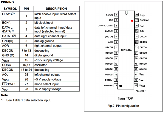

Pin 27 of TDA will be -5v if they are using Sim mode.

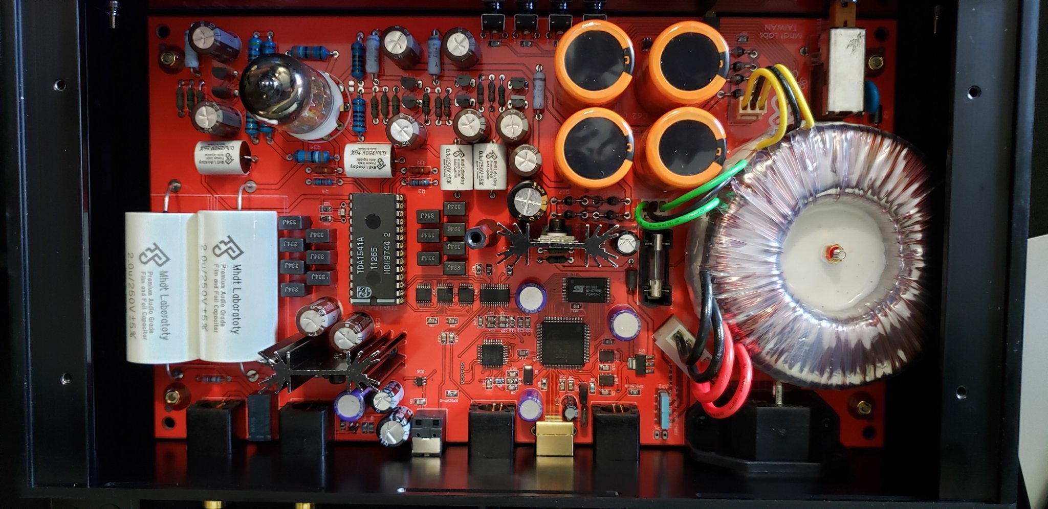

Here is a pix of the guts for the latest Orchid. Its a TDA 1541A not and R that I first thought.
Reactions: SonocusEric
Just measured pin 26 to pin 14 GND and with the correct polarity is + 5.00 volts not - 5.00 volts.
This means its operating in time MUX TWC ?
From the spec sheet:
When input OB/TWC input is connected to VDD1 the two channels of data (L/R) are input simultaneously via DATA L and DATA R, accompanied with BCK and a latch-enable input (LE). With this mode selected the data must be in offset binary. The converted samples appear at the output at the positive going transition of the latch enable signal.
it is not clear what You did at all?
first pin 27 in focus. Not pin 26 that is -V power pin (-5V)...
second connect correctly hand probes on voltmeter.
If it is TS format You should read -5V
(for other formats please read the datasheet)
Pin 27 is in between 26 (-5V power) and 28 (+5V power) for easy choice of that 2 settings...

My bad....I meant to say measured pin 27 to ground.
Across 27 to 14.
27 is indeed +5VDC. not -5VDC.
And yes the polarity was correct. Black probe common to pin 14 ground...red lead + to pin 27.
So no simultaneous mode...so what does this really mean for "anything" ??

No need to measure the voltage of the Orchid as on the picture there are only three traces going to the tda inputs...so NO simultaneous. However what are those bunch of 3 ICs on the I2S lines?
Notice it uses a ceramic class 1 as dem clocking cap with what looks like 2 resistors arrengement from ECDESIGNS....bouhhhhh copycat ?
Reactions: weissi
Which device is the ceramic clocking cap?
