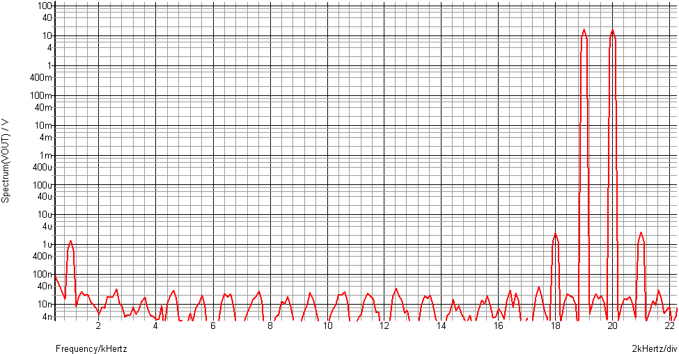

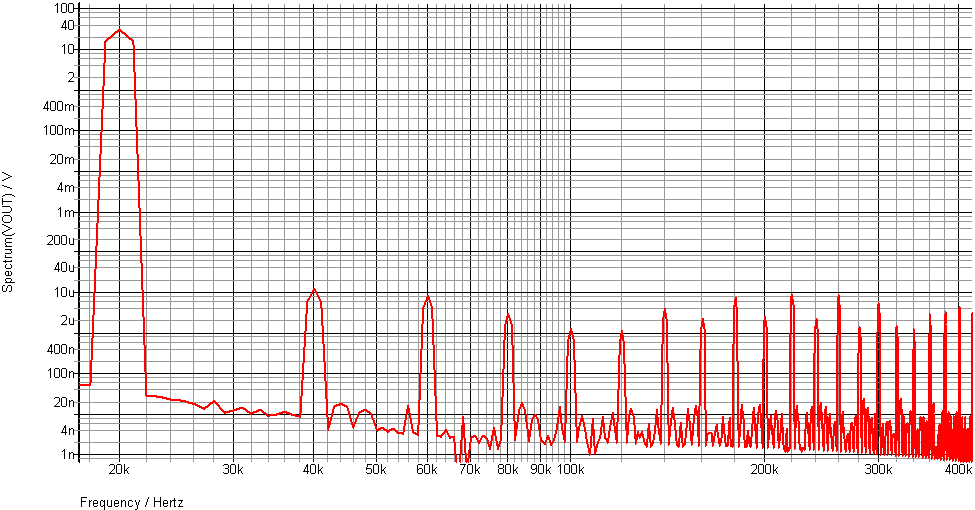

Best perfs/complexity ratios are obtained first by Cherry like designs with nested feedback loops, second is the 741 topology, aka blameless, and third is the full symetrical topology.
Linearity wise the first quoted is about out of reach by the two other topologies at the higher audio frequencies, said topologies can be partly used of course as a basis for a NDFL amp.
