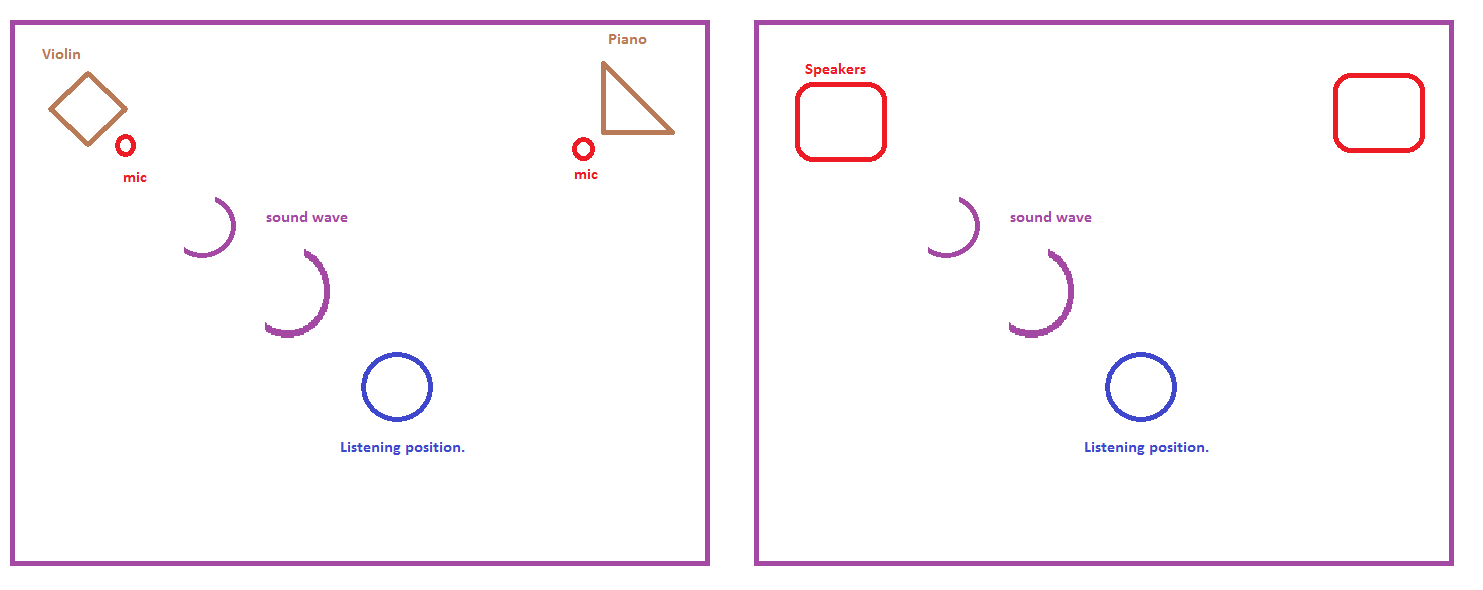

Why 2nd Order Is best or not
would you tell the difference in a dark room ? 😀

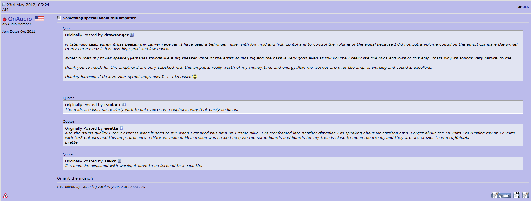

However the perfect speaker requires a suitable companion such as the SYMEF, which is fabled to bring the ladies into the listening space.

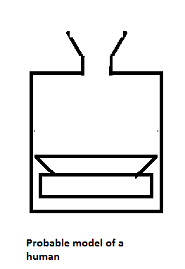

natural systems
In nature the most occuring systems are vented enclosures and open baffles.
Human beings and most animals could be modeled as vented enclosures with an adjustable tuned port. Guitars and many stringed instruments also fall into this category of vented enclosures.
A harp among others could be modelled as open baffle.
Thus a sytem that is focused on proper mimicry will employ a variety of technics.
