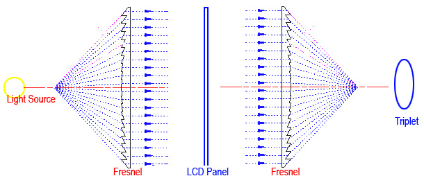

ok now after searching on google,forum's and D2D's reply i am more clear and here i ma uploading a diagram , i suppose i am clear on this, this means single fresnel wont work?
but how come then the OHP has only one fresnel?
i had burnt my OHP's frensel so i broke it open ...and it was ripped in two with both sides having the grooves, does that mean ohp uses 2 fresnel?
this is not corcerned with forum, but if anybody can put some light on this topic?
Parag
The Diagram
here i made a diagram in photoshop,
i think this is how it would work?
PD

Yes, you have got it, there is actually two Fresnels in "most?" OHP's they are usually stuck together, with the grooves facing each other.
It is a bit risky splitting fresnels, but it can be done, if you are careful.
As you have damaged yours, you need to get new ones. 🙁
As for this not being relevent? it surely is, as lots of people on this forum, and others, use Fresnels, split or unsplit.
The split fresnel giving the best results. (IMO)
Your pic is a good representation of how they work!
OHP's have two Fresnels, stuck together, as you have found out!
D2D

I believe the reason to use 2 fresnel lens instead of 1 fresnel is that:
If the light from a point light source hit the ridged side of the fresnel, a large amount of light hits on the off-center area of the fresnel will be reflected or even be totally reflected because of the "Critical Angle". However, the parellel light source does not have the problem of uneven reflection loss on the ridged side of the fresnel. Also, the smooth side of the fresnel does not cause significant uneven reflection problem, and this is why to face the smooth side of fresnel toward the bulb.
The function of the first fresnel is to make the point light source into parellel light source, so to avoid the "total reflection" on the ridge side of the second fresnel. The function of the second fresnel is to converge the parellel light send the light to the projecting lens.

desperadok said:
I say the rigid side never face the light source, unless the light source is parallel light source. We probably need some professional to settle this issue.
I agree, most fresnels i have seen, have the smooth side facing the light, and if you are using the split fresnel method, the second one has the ridged side towards the LCD/light.
I think that the smooth side facing the lamp, the fresnel spreads, (defuses?) the light entering it into paralell rays, while the other way, (ridges facing lamp,) it focuses? the light to a point, i.e. the projection lens.
If i remove my second fresnel from my PJ, only the center of the picture is projected, the paralell light going through the LCD mostly missing the PJ lens. 🙂
So i think that there might be ways of getting away without the first fresnel, IMO the second fresnel is necessary to direct the image to a smaller size to fit the PJ lens, otherwise you would need a PJ lens that covers the whole LCD area, to collect the paralell rays leaving the LCD. (like in a slide projector the lens is bigger than the slide)
