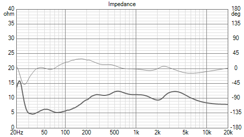

Take a look at the attached loudspeaker impedance curve, which might have a "rated frequency range" of 40 Hz to 20 kHz or so (I know because I designed and built that speaker). The impedance drops to just below 5 Ohm at 35 Hz, so this would go as a 4 Ohm speaker. If the "rated frequency range" would be specified as 150 Hz to 20 kHz instead, this would change to an 8 Ohm speaker (without changing the speaker in any way, really). Using the "400 Hz" rule, one might even claim this to be a 16 Ohm speaker.
I guess the lesson here is that one should stop caring about the "nominal impedance" rating and always look at the entire impedance curve!

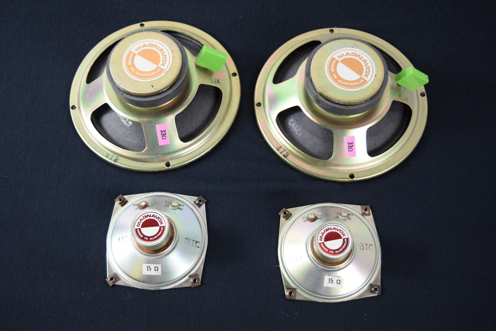

I wonder what the story behind these 33R drivers is?I guess that explains why 16R is usually the highest impedance you find and getting 24R is difficult/expensive.
