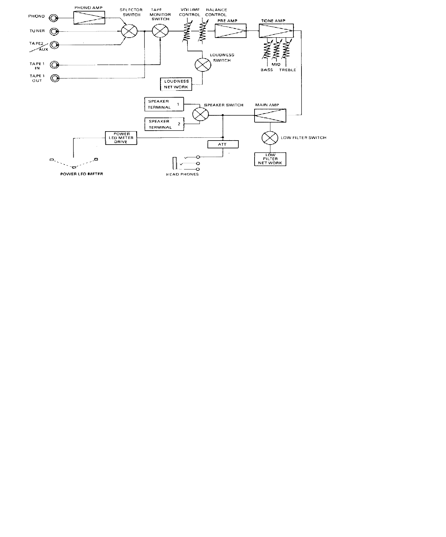

marantz PM 350 as a very simple example
You may see the block diagram and the principal of operation copy from the service manual
Phono stage
selector switch
tape monitors
passive volume and balance control
18db ( !!! ) gain stage
tone control locally buffered
and main amplifier with impedance a bit above 33K
Ok i expect some losses from input termination probably filtering and some other losse from the passive volume and balance but could you please explain to me why the **** you need to have a 18db gain stage to drive a normal amplifier ?
Ok we have to take in mind that sources at the time was tuners and decks had 100-400mv output and obviously now days with 2 volt sources a 18db gain stage will be an obvious overkill But now days in amplifier that have CD inputs also gain stage exists but with not that much gain ....

That's a pretty common topology but just because they've done it that way for 40 or more years doesn't mean it's best or appropriate forever. It's not how I'd design a receiver today!
Conrad you are probably right ... no arguments about that ... still in many consumer amps the topology today is alike only numbers are changed ...regarding gain
