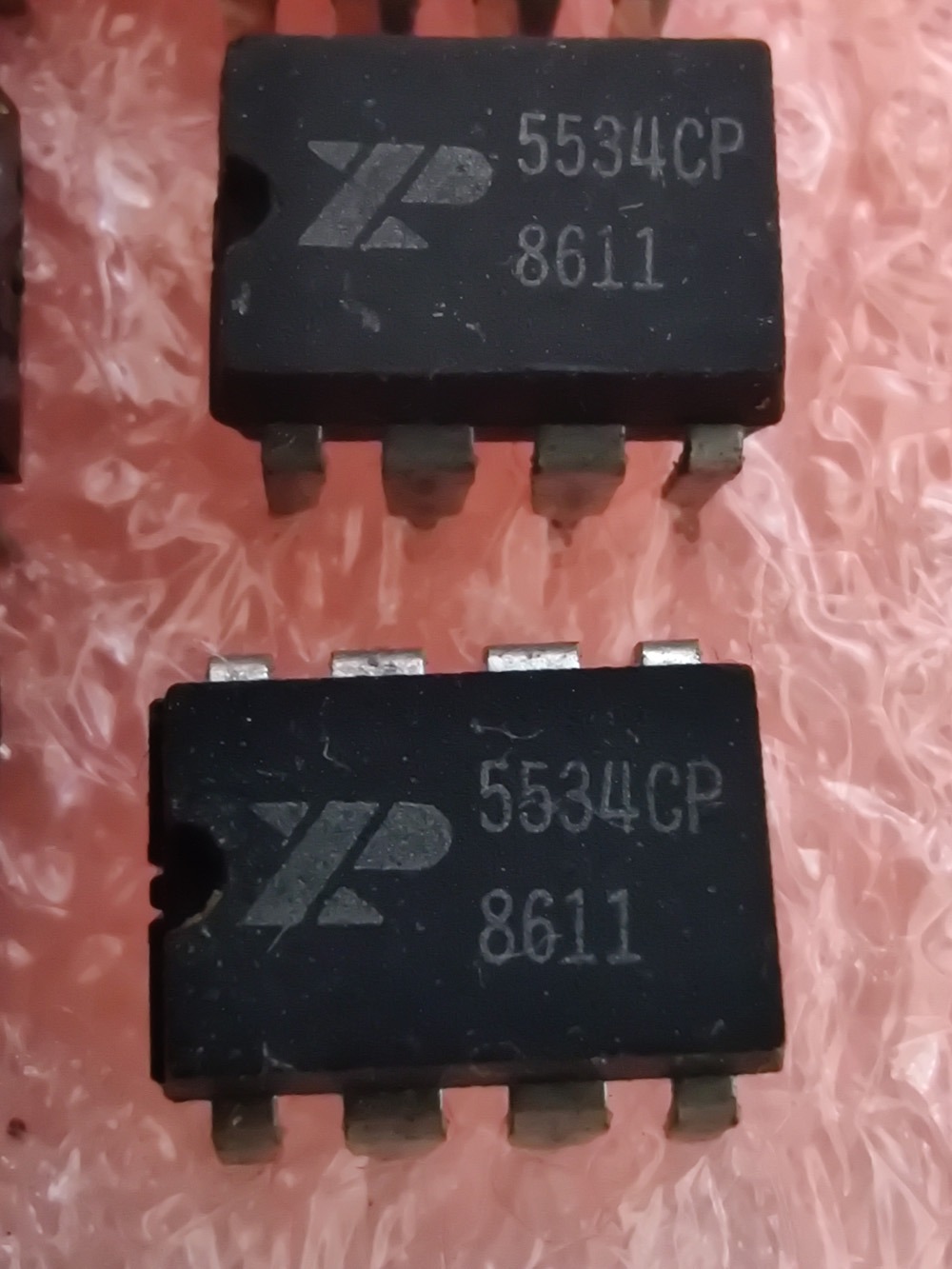

I have a couple of those. Manufactured in 1986 (?). What is the difference between ACN, CN, and CP suffixes?

Interesting, so still making them in '86. Are those ceramic or plastic package? I'd guess the P stands for the latter, A is for guaranteed offset or noise spec, and C is a 'normal' grade.

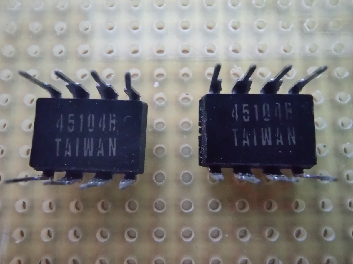

Definitely plastic. I bought them from a downtown shop back in the day for making a line preamp with output offset trim. After the preamp was no more I pulled them out. They don't come from a modern online auction, no chance they are reprinted. I should have had same period XR 5532s in a diy phono as well. Here's a photo of the XR 5534s "dark side" also.

The ACN and CN are tested for noise density and input CMRR but the CP is untested standard version.
