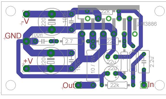

It's mine, it works from last year until now. If you need any other information, I will be happy to answer.
Actually this is the view from EAGLE. The files were posted already here:

Actually, I've already used your design to make a board, but I haven't put it together beacause I don't know if i it works, but now I know, so I'll carry on with it!
But what does the power resistor do? I haven't seen it on other boards, I think!
And one question about the LM3886T, non-isolated, can I put it on the heatsink without isolation as long as the heatsink isn't connected to something, or do I short it if I do so?
It is a 'mirrored view'.
So my guess was right. The PCB posted above should be a view as seen from the bottom side of the PCB.
Where the tracks are, but not the components.

Hi lineup,
Not mirrored, it is a view looking from above.

I think you should do a mirrored print for those who do not understand and use an iron and laser print.
That resistor is a 10ohm/3W which has 10 turns of 1mm copper wire. My boards are using the non insulated but my case is made out of wood. If the heatsink doesn't touch any other connected metallic part, it's fine.
For those who use press'n'peel: don't print the view in mirror, print it exactly how it's in EAGLE. Leave only pads, bottom and dimension in view then at print options choose "Solid" and "Black"
Okay!
Then I'm good to go! Hopefully the amps are done pretty soon and then I'll show them here!
