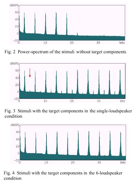

From a paper presented at the 110th AES Convention:
Detection Threshold for Tones above 22kHz
Kaoru Ashihara & Shogo Kiryu
Electrotechnical Laboratory, Tsukuba, Japan
To investigate audibility of ultrasounds contained in a complex tone, psycho-acoustic experiments were designed. Human subjects were required to discriminate stimuli with and without components above 22kHz. All subjects distinguished between sounds with and without ultrasounds only when the stimulus was presented through a single loudspeaker. When the stimulus was divided into six bands of frequencies and presented through 6 loudspeakers in order to reduce intermodulation distortions, no subject could detect any ultrasounds. It was concluded that addition of ultrasounds might affect sound impression by means of some non-linear interaction that might occur in the loudspeakers.
Paper 5401
100% of participants in the double blind study heard intermodulation distortion artifacts in a tweeter producing ultrasonic signals they could not hear in isolation from audible signals .
