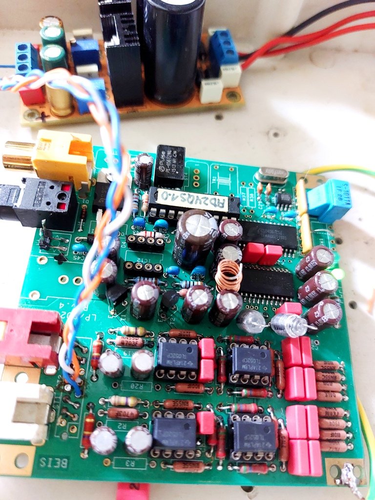

Uwe Beis AD24QS ADC (unfortunately unavailable today), is probably the only and maybe the last DIY audio-ADC that was through-hole (apart from the actual ICs).
That by itself, made it a great candidate for an audiophile device.
To be tweaked according to one's taste.
But even in that case, although Beis had offered a very nice quality PCB, the space was limited to fit (or de-solder!) larger components.
It made it pretty hard to figure ways to fit anything else, than the recommended ceramic capacitors and standard electrolytics (at critical positions like the audio inputs).
But, it was still possible, exaclty because it was NOT using dreadful SMD parts.
Here is Uwe's ADC with selected parts (Dale resistors, Wima caps, Styroflex caps etc) and powered with optional, dual-voltage, linear PSU:

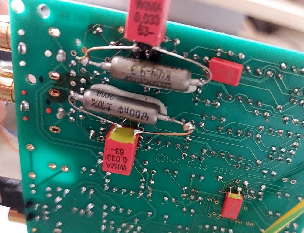

Underneath, was the only space to fit better caps:
