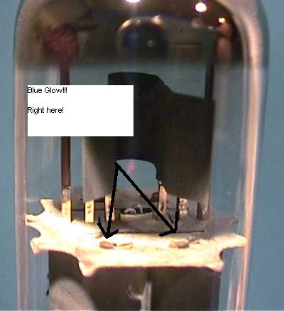

hey, I just yesterday tried to wire my EL34 amp as a pentode amplfier, and I was a little puzzled by the resuslts.
I let the amp heat-up in standby move for a good minute while I took a picture of the amp, I flicked the switch to let the B+ into the amplifier, and I heard a pop through the speakers it wasnt a bad sounding pop, but it was rather loud, although I think it was the same pop I hear everytime I turn it off standby, even when the amp was triode-strapped.
well I flicked the switch, and saw blue glow where indicated in the picture on both power tubes, there was no arching, and no sound coming out of the speaker (the volume was turned al the way down).
I saw this, and got the crap scared out of me and turned the amp off after about 5 seconds, I didn't dare turn up the volume in that time
is this in anyway, shape or form, normal?

I assume that you DID the usual measures when converting an amp from triode to pentode mode:
  • re-set the bias, pentode mode will draw higher current
  • protect the screen grid with a 1k resistor
I can't understand from your picture if the glow was near the screen grid (bad) or near the glass (normal).

It was near the screen grid....
I am pretty sure my bias was set for pentode mode, but I will double check
I didn't protect the screen gird... uh oh!
what exactly do i do? put a 1k resistor between the B+ and the grid?
YES. The original Mullard literature states that 1K ohms in series with the screen grid gives the lowest distortion in Ultralinear mode. I found that I like the sound better with a lower value, like 330 ohms. I have the resistor mounted right at the socket pins. It is in the circuit in all 3 modes.

Hi Tom,
Screen grid absorbs current. It has characteristic curves like the plate ones, but a function of the signal grid voltage and screen voltage.
In fact, the recommended method to set screen voltage according to RDH4 is to use a single resistor, besides the bypass capacitor to cathode.
If we don't put a resistor in the screen circuit for certain tubes (EL34 one of the usual suspects), we get that the grid current and so the dissipated screen power, without any limitation, could be higher than the rated maximum, which depends on the screen grid mechanical construction characteristics.
Then we get "glowing" screen grids and if lucky, don't lose an OPT...
We can suppose that the DC resistance of the OPT is enough to limit the value of the current to a safe limit but it would depend on the tube make, the transformer and other factors that can be easily avoided with the simple addition of a humble resistor.
IIRC, EL84 doesn't show this kind of behavoir.
And no, I like fuses to fuse and resistors to just heat 🙂
Gastón
