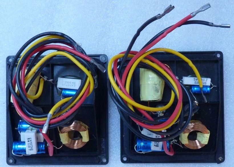

Does anyone know who manufactures ALCAP capacitors? I’m trying to discover whether they’re OEM caps, or rebranded, what the difference between normal and low loss is and find a spec sheet for them etc. Or even, who distributes them for the manufacturer, if indeed, there is a distributor! They’re pretty elusive, and prolonged searching on the internet has drawn a complete blank.

Falcon Acoustics supplies Alcap 50V Standard, 50V Low Loss and 100V High Power capacitors.

A low dielectric loss capacitor has a smaller ESR (Equivalent Series Resistance) than a standard capacitor.

I am in the midst of trying to locate a primary distributor of ALCAP capacitors in North America. There doesn't seem to be a manufacturer's webpage (IE: www.alcap.com does not exist), nor do ALCAPs appear on any of the major online electronic distribution sites in North America. Does anyone have a link to "the Source" of ALCAPs? I am trying to see if I can assemble the same grouping of caps' that are available from Falcon Acoustics, but sourced in North America (Canada preferably).

I disassembled my KEF 104.2 crossovers and see that they originally used some kind of OEM "KEF Branded" capacitors ~ some audio-geek sites say that these are ALCAPs as well, under a KEF OEM rebrand...

As far as I’m aware, Falcon are the only supplier. They get them manufactured to order and will supply any value, subject to a minimum order.
In the Kef104/2 they used both Alcap and Kef badged caps.
You should first measure them all. Falcon is your best bet, more expensive to sort out values by yourself.

About the 14/2 : The LL marked can be swapped by MKT caps for the small values less than 8 uF. There is really no room on the pcb for something else than lythics for the others.
Diyggy - did you notice on the KEF crossover that only a few of the original caps were marked as "10%", only the "LL" (long life?) caps in fact. The rest... I dunno', back in the day, perhaps 10% tolerance caps were very rare?
"LL" (long life?)
Low loss or low dielectric loss to give it its full title.
Such capacitors have a low equivalent series resistance (ESR), making them more akin to plastic film capacitors such as the MKT types that diyiggy mentioned.
