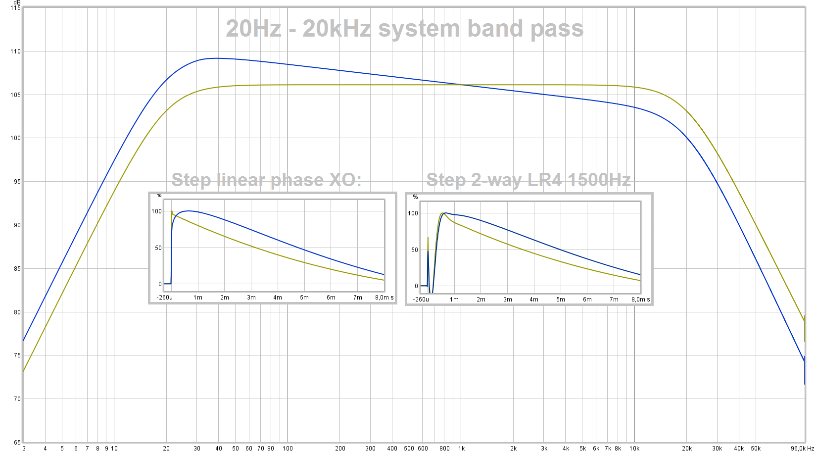

After measuring the curve I ended up with, it was impossible to deny the resemblance. My biggest deviation from this graph is in the mid/side EQ I use to get the most pleasing tonal balance all trough the stage from left and right compared to the phantom center.
Your approach sounds (pun intended) rational, but I am not clear on what you mean by "mid/side EQ ". And what do you use to EQ your system? The JBL "trained listener" curve is just about identical to my goal as well.

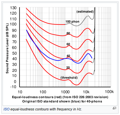

I wonder, when EQing to a non-flat curve, is it a practice to always calibrate playback level to a certain SPL at a specific listening distance? I am thinking that the response should be flat so that you can always calibrate it to a specific SPL then adjust the EQ to based on volume variation and the ear sensitivity curves for different listening levels.
@gedlee My EQ is done with FIR based convolution, based on a (user variable based) frequency dependent window.
The mid/side EQ I use are linear phase EQ tweaks that have an influence on the cross talk perceived in Stereo (well at least if there aren't any early reflections one could perceive this difference).
It consists of subtle tweaks that make a tonal improvement for my setup. Aimed to get equal tonal balance in the phantom center and the separate L and R sides. Most notably it also had improved intelligibility of phantom center voices.
It works even better on Home Theatre material, mixed back to a Stereo signal as I do not have a center channel. It uses the same mid/side tools but with a stronger correction.

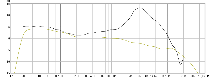

Agree with wesayso and gedlee about that JBL study curve simply works excellent, they also have it translated to use as a very good sounding head phone target curve seen below. Can see a couple of reasons why it works so good, one is because the declining curve as frq goes up more or less replicate some nature of HF in free air and the other that many studios probably have same response dialed in. In graphs comparing flat verse the declining curve reveal in step or sq-wave response we get a softer attack and a warmer tail whatever XO adds excess phase or not.
Because it sounds so good my own use have become set something close to the JBL curve for speakers and the Harman curve for head phones and thereafter adjust settings for equal loudness (ISO_226-2003) SPL numbers in JRiver player relative to playback level.
The Harman and JBL curves actually confuse me. If high frequencies attenuate more in air, wouldn’t we want to do the reverse?
Additionally, wouldn’t we want to first measure frequency response of drivers at a design reference SPL, say 85db@3M for a small system, instead of 1M 1W?
I am not saying I disagree with others, but looking at the technical reasoning, the droop in speaker and rise in earphone does not seem to make sense.

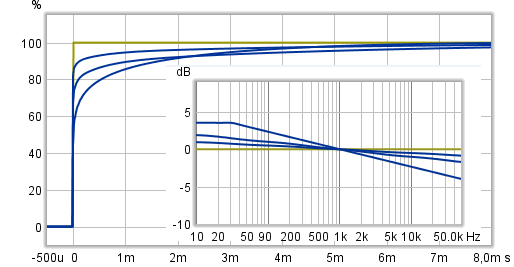

Let's not forget that the HF slope interacts with the HF DI. For example a rising DI to a very high DI at the highest frequencies (like a piston source) sounds about right if the axial response is near flat. But take a waveguide with a flat DI that does not rise at the highest frequencies and if it is set to flat on axis then it will sound very bright. And, of course, this is also affected to a certain respect by the rooms absorption.
The Harman and JBL curves actually confuse me. If high frequencies attenuate more in air, wouldn’t we want to do the reverse?...
Think the best argument to use is if many pro's use something more or less close to JBL curve to produce our material then it should bring us closer to their decided mix shouldn't it.
A personal thought and guess about we want to copy HF attenuate scheme from outside nature is because our hearing is never used to from outside hear a theoretical full speed attack for step without some more or less HF attenuate will kick in as in below 3 times blue examples with varying droop verse the gold trace theoretical ideal, and now add than outside in nature HF band is not summed with reflections from any close boundary's and therefor something close to JBL curve is a god target to replicate nature and also filter out a bit of that indoor unnatural HF reflections.
...Additionally, wouldn’t we want to first measure frequency response of drivers at a design reference SPL, say 85db@3M for a small system, instead of 1M 1W?...
Think that's right but not everybody has either the right steered DI or allowed by other family members to treat a living room area to get there and for that case 1 meter is the compromise for response and equal loudness (ISO_226-2003) could be dialed in at 3 meter.
...I am not saying I disagree with others, but looking at the technical reasoning, the droop in speaker and rise in earphone does not seem to make sense.
For that Harman head phone curve they write it replicate how a good speaker target curve will look for a good speaker in a good room, and think tells us that our ears haven't the same response using head phones verse not and guess if we divide those two curves we have what science points out about it if that makes sense why speaker target curve is a droop and head phone target curve is a rise and then a droop.
It just seems that me the engineering basis information is lacking. If the JBL curve were based on fact that most people are not going to calibrate to 85db SPL reference, but lower, then it would make sense.
I can understand that earplug type phones would interact with the canal, but it seems most of these types are for use on stage where the performers need to coordinate in some way, so I would not think those would matter fidelity wise.

I am of the mind that EQ will be related to DI (as opposed to the default 'flat' response). There is some choice involved in designing the speaker, so I consider this EQ as - prior to preference EQ.
