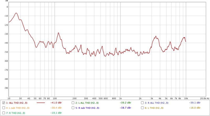

Yes, sure matters to those of us who are enthusiasts for the clean sound of ESLs.
Attached is a normalized-to-fundamental THD curve for my speakers which has THD across most of the most audible band around -50dB (.3%).... and that includes passing trucks, mic, laptop, DSP, USB, SPDIF, and my old amps*.
REW sometimes complains that my THD results are so low they are falling into the bottom mud level and it just doesn't want to display them (REW users will know what I am talking about here). Ah, well....
B.

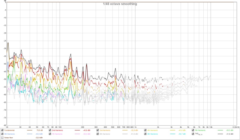

It matters to me too, as an array lover. But I don't worry about it once it's down far enough.
What do I consider far enough? The objective was below 1% from 200 Hz and up, I'm comfortably there.
As measured at the listening position, probably not the best example I can come up with, I was just testing a new amplifier.
This also includes traffic noise, DSP etc, -3 dB at 17 Hz and ~17 kHz. This graph is also normalised to fundamental.
No crossovers, just many drivers.
