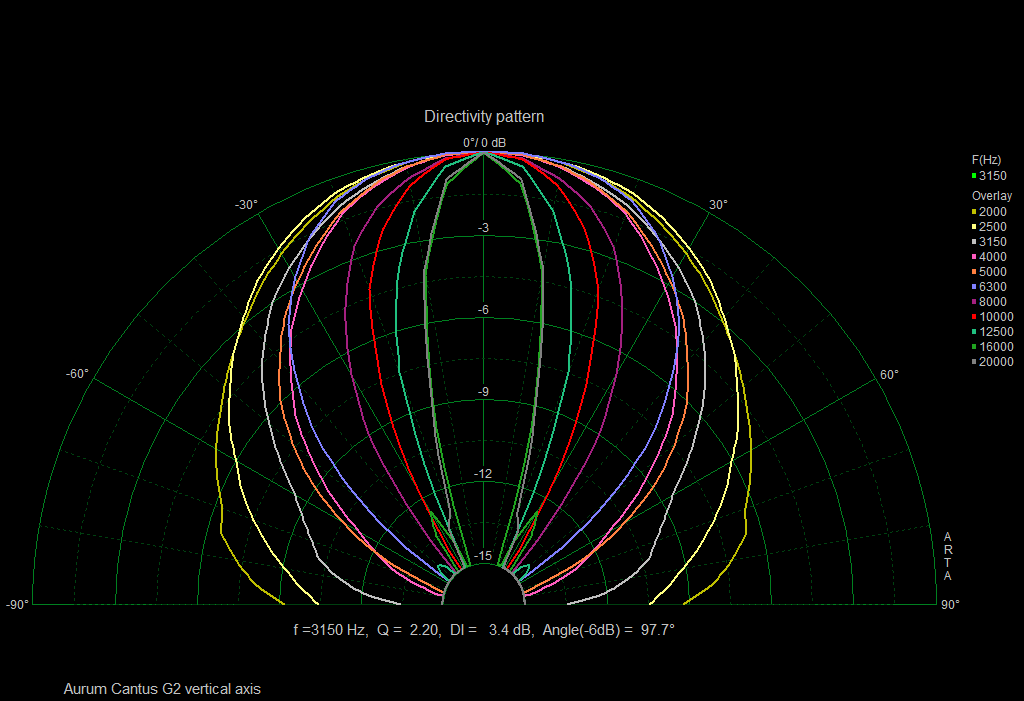

In a typical application, a ribbon tweeter is also usually taller in size than it is wide, in a ratio in the range 2:1 to 3:1. As a result, its vertical dispersion will be characterised by a strong frontal lobe and then a number of side lobes on either side. This can be beneficial in a recording studio near-field listening environment, as the intensity of the sound reflection from the table or mixing console upon which the loudspeaker sits will be reduced."
The claim of "a number of side lobes" is incorrect. On a 50mm tall ribbon there are no significant side lobes in the vertical plane. I have a full set of vertical and horizontal off axis measurements I took of my tweeters years ago.
I just reviewed them to double check and there are no vertical side lobes at all over the majority of the tweeters range, and two minor vertical side lobes around 16Khz at 30 degrees off axis right down at about -12dB - so basically insignificant. See below:
670457d1521800177-makes-lowest-distortion-speaker-drivers-aurum-cantus-g2-vertical-png
If you used a much longer ribbon side lobes in the vertical plane might be an issue, but not in one that fits into the same size faceplate as a comparable dome tweeter.

So what are the characteristics of a ribbon tweeter with an 8.5mm wide 50mm tall (visible) ribbon in a waveguide like the ones I use ?
In the horizontal plane the 8.5mm ribbon is a lot narrower than a 25mm dome, so the horizontal directivity is completely under the control of the waveguide design.
Horizontal directivity is kept between 120 degrees and 90 degrees from 2Khz up to about 15Khz, and it starts to narrow slightly above that. Below 2Khz pattern control completely collapses.
It looks very similar to a CD waveguide in the horizontal plane and its not surprising when you look at the profile of the sides of the waveguide which are basically straight +/-45 degrees chamfers with slight radiusing at the ends, similar to a CD waveguide.
The benefit of this is that in the horizontal plane out to about 45 degrees either side the frequency response is very uniform with almost none of the fall off of the top end that you would see from a 25mm wide dome tweeter. And when you go beyond +/-45 degrees the amplitude starts to drop away but it still remains relatively flat above 2Khz.
So any sidewall reflection is going to be spectrally balanced, which is considered to be good for imaging and spaciousness, whereas with a dome tweeter the top end of the treble will be rolled off in the sidewall reflection.
In the vertical plane the response is very different - it is as shown above, and is similar to what you'd see from a 50mm cone driver - a smooth uniform tapering off of the high frequency response the further you go off the vertical axis.
It's wide enough in the vertical plane to accommodate a variety of seating heights but narrow enough that if you stood up you will hear the top end of the treble roll off a little.
This is usually stated as a disadvantage for a ribbon tweeter, but I think it's actually an advantage, for two reasons.

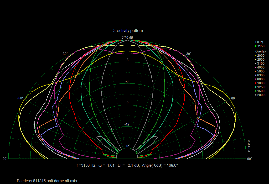

By the way, just for laughs, here is the off axis response of a Peerless 811815 soft dome measured on the same baffle at the same time as the Aurum Cantus vertical dispersion measurement:
attachment.php
Pretty horrendous. 😀 It's not really the drivers fault, it shows what happens when a driver has no directivity control - all of the lumps and bumps in the polar response are due to the diffraction from the edge of the cabinet summing and cancelling at different angles. Notice how at higher frequencies (about 10Khz) where the dome becomes more directional the polar response becomes a lot cleaner and better shaped. But at lower frequencies it's a disaster.
The driver with directivity control of its own (waveguide) does not illuminate the cabinet edges and thus you don't get the same garbage looking polar response plots that are due to diffraction.
A good lesson for why making a tweeter have extremely wide dispersion is actually a bad idea. At least if it will be mounted on a conventional baffle...
