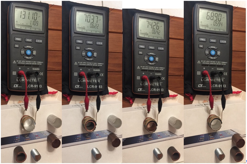

More interesting findings. I took a driver using this coil and measured the inductance, pretty much the same value as the individual voice coil, 126uH. Then I dug up a version that had a shorting ring, 31.3uH. This is quite interesting.
It doesn't have to have look inductive to do work, remember. We want opposition to the flow of current to come from it acting as a motor and doing work, in which case it should look resistive.
In the case of motors I am familiar with, inductance is sometimes designed in to limit current flow if the motor is stalled. But, other than that they don't need to appear as inductive.

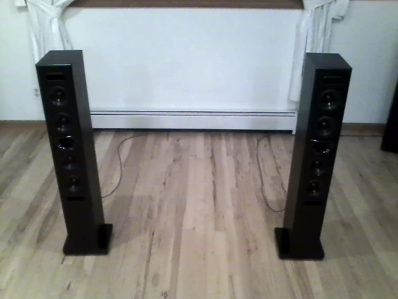

I was listening to some old records through my array speakers with paper drivers and horn tweeters. I was amazed at how warm and rich the sound was.
I'm starting to think there is something to the whole euphonic distortion thing.
First, the assumption is always that accuracy in a transducer is the most important thing. But when you listen to music you don't analyze. Rather you get lulled into a relaxing right brain activity. The speaker sort of seduces you.
Thus a source-speaker-room combo that is relaxing creates this brain change quicker and easier. It's entirely possible that certain harmonics and also dispersion patterns are more relaxing, but not necessarily more accurate.
Another assumption I believe is false is that the speaker is supposed to remove itself from the sound. The problem here again is the assumption. What if our brains want and expect to hear subtle sounds and idiosyncracies from the speakers themselves, the subtle break up of a paper woofer for example. This adds cohesion that makes a performance, not just sound.
For example my pistonic PC controlled speakers that I built sound cleaner, but just don't lull me into the music the same way.
Blind tests aren't the way to measure this, because our preference over time will be for the sounds that we enjoy more, not necessarily accuracy.

Lots of hypotheses offered with no evidence. On the other hand, the other side, those "false assumptions" are supported by a great deal of evidence. This is the kind of rebuttal that always happens when one wants to believe what they want to believe even though it is contrary to the facts.

I have never said that "distortion" does not matter. Linear distortion, diffraction, both these matter. What one cannot do is use THD or IMD numbers as an indication of how something will sound, THEY simply don't matter. And I agree with Wesayso that once one gets below a certain level of nonlinear distortion it no longer matters. What that level actually is has never been clearly defined since, as I said, one cannot use THD or IMD numbers for this task.
Polkhigh made three claims that I disagree with based on the evidence:1) that accuracy is not what we want, that's not what Toole and Olive find; 2) that the loudspeakers should not "disappear", although not framed in those terms the same researchers find that accuracy and hence disappearance IS what people prefer; and last but not least 3) that "blind" is not correct - only blind studies have any validity. That is well known in all psycho-based research.
