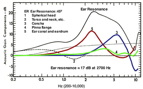

Our outer ear does some serious eq'ing (+10-15dB!) of sound before it reaches the ear drum.
This is largely bypassed when using headphones consequently 'phones with a flat measured response do not sound anything like flat.
However every manufacturer of 'phones uses a different model of pinnae to design theirs. The trick is to find the manufacturer whose pinnae model most closely resembles yours. For me that manufacturer is Beyer, others get better results with Sennheiser, Audio Technica or others.
The only time headphones should have a flat FR is when playing dummy head recordings which record the pinnae eq.
This is largely bypassed when using headphones consequently 'phones with a flat measured response do not sound anything like flat...
To put it in a picture to better compare against measured headphone/IEM responses:

I've done a lot of in-ear headphone measurements and looked at the theory of the EQ somewhat. So has Sean Olive at JBL. We both have concluded that the common idea of free-field equalization, which are the curves shown above, is not correct. What one has to remember is that that data was taken with an open ear canal. When the ear is occluded the curves would be completely different. So its been a mystery for a long time trying to figure out what curve does sound best. As I recall, Sean came up with the same thing that I did, which is basically that flat response still sounds best. That would not be true if we were trying to EQ to externalize the sound, i.e. remove the in-the-head sound, but if what one wants is just a satisfying sound then basic flat works very well.
