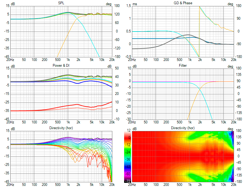

And then another 8" driver with heaps of distortion... like 11% H2 and 387% H3 in a properly designed waveguided 2 way.
(see post: https://www.diyaudio.com/community/...istortion-speaker-drivers.294787/post-7094796)
In a new era with DSP it's much easier to get the on and off axis or CTA2034A virtually identical with a very similar preference score and then compare!
