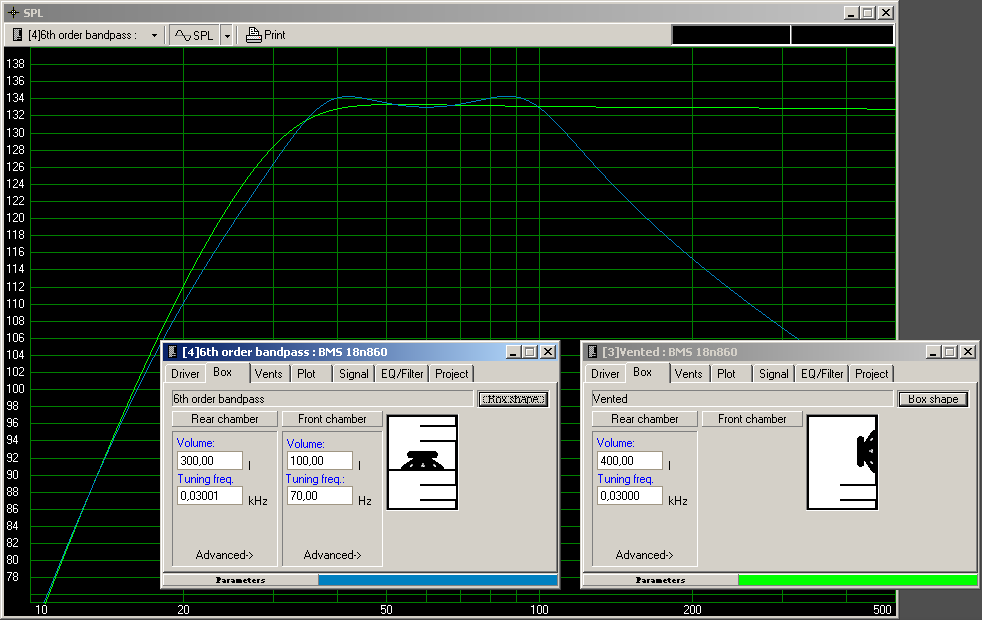

To get started, how about a low cutoff at 30Hz. The attached picture shows both a vented (reflex tuned) and a bandpass (6th order) alignment of 400l (ca. 14 1/8 cubic ft.) at the speakers' excursion limit. For the sake of exaggeration, two units per enclosure are employed. 😀
The simulation is of course preliminary, but you can always guesstimate that:
1. This is a serious oven, we're talking 4kW+ of hot air... 😉
2. You've got headroom until 110dB SPL at 20Hz even with this 'classic' alignments...
3. There's no woofer required, you can get away with 'only' a 12" or 15" speaker in the midrange...
An alignment tuned lower could provide you with more dynamics in the 20Hz range at the expense of ridiculous box volume and reduced upper bass. A Linkwitz transform comes to mind. :smash:
Sebastian.
Sebastian.
I came to the same conclusion
AE 12M or 15M in a 2way could be interesting with subs
The BMS in bandpass ? I will think about that ... I believe its best with lower Qts fore a 6th order bandpass ? Fore a bandpass there may be other/better driver options ?
