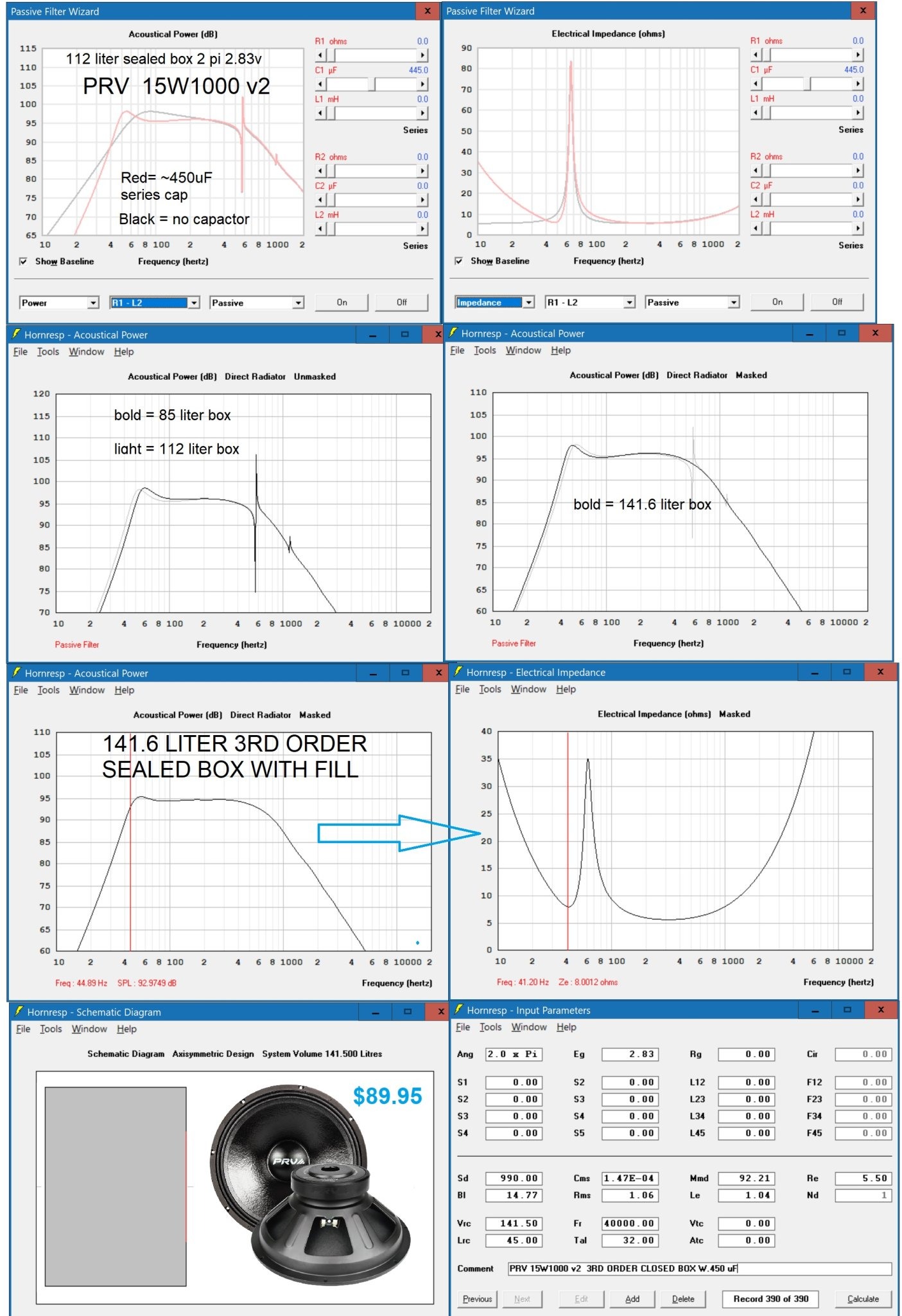

ok the reason for a f3 at 50hz and a 3 to 5 cut box is that i have an old 3cuft sub box and a 5 cuft box
i have a pair of altec santana with the biflex woofer for my home theater and had upgraded the twitter to a pe planner ribbon tweeter and wanted a similar driver with the smaller box and there are many tweeters with waveguides or some ribbons that work well without drastic attenuation ,for the bigger box i have a few horns that play well in the 95 db range(hepner,magnavox,sansei etc) ,i also have many other cd drivers and horns that i wanted to experiment with.
there are plenty of subwoofers for me to play with(BR,ppsl,th,etc)
so the ask was a woofer that can do this,
freed i like that idea but what does it do to the phase and inductance?

is there a driver like the alter 420A ?

What clean sound pressure level do you want to achieve at 50 Hz? You can just go buy an Altec 420A. It has 25 Watt power handling and an Xmax of 0.15 inches. So that's a great option if you plan to run a Marantz 8 tube amp with 25 Watts of power. You should expect a max output of 106.5 dB at one meter when driven to Xmax at 50 Hz. http://alteclansingunofficial.nlenet.net/Thiele-Small.html
