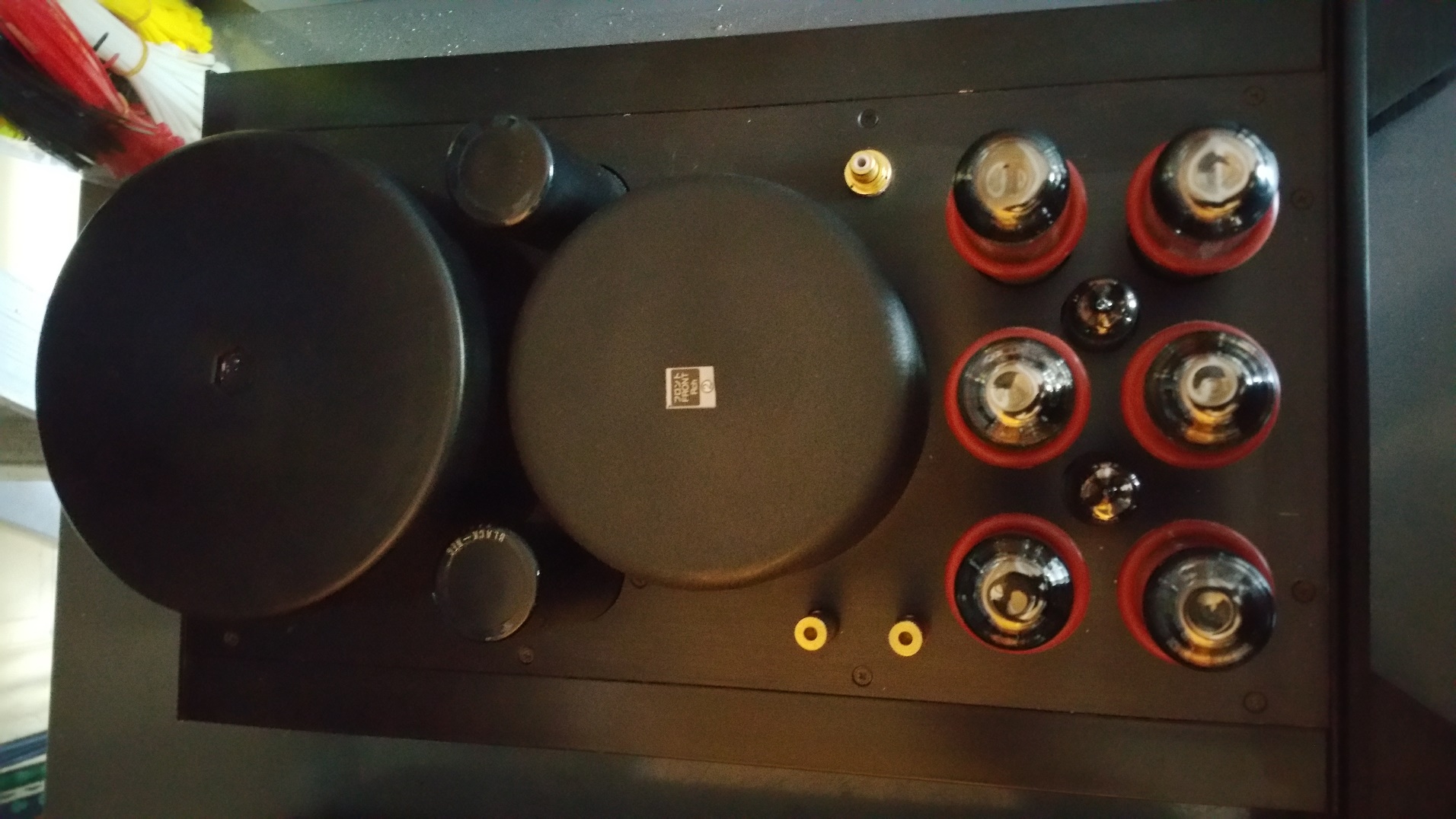

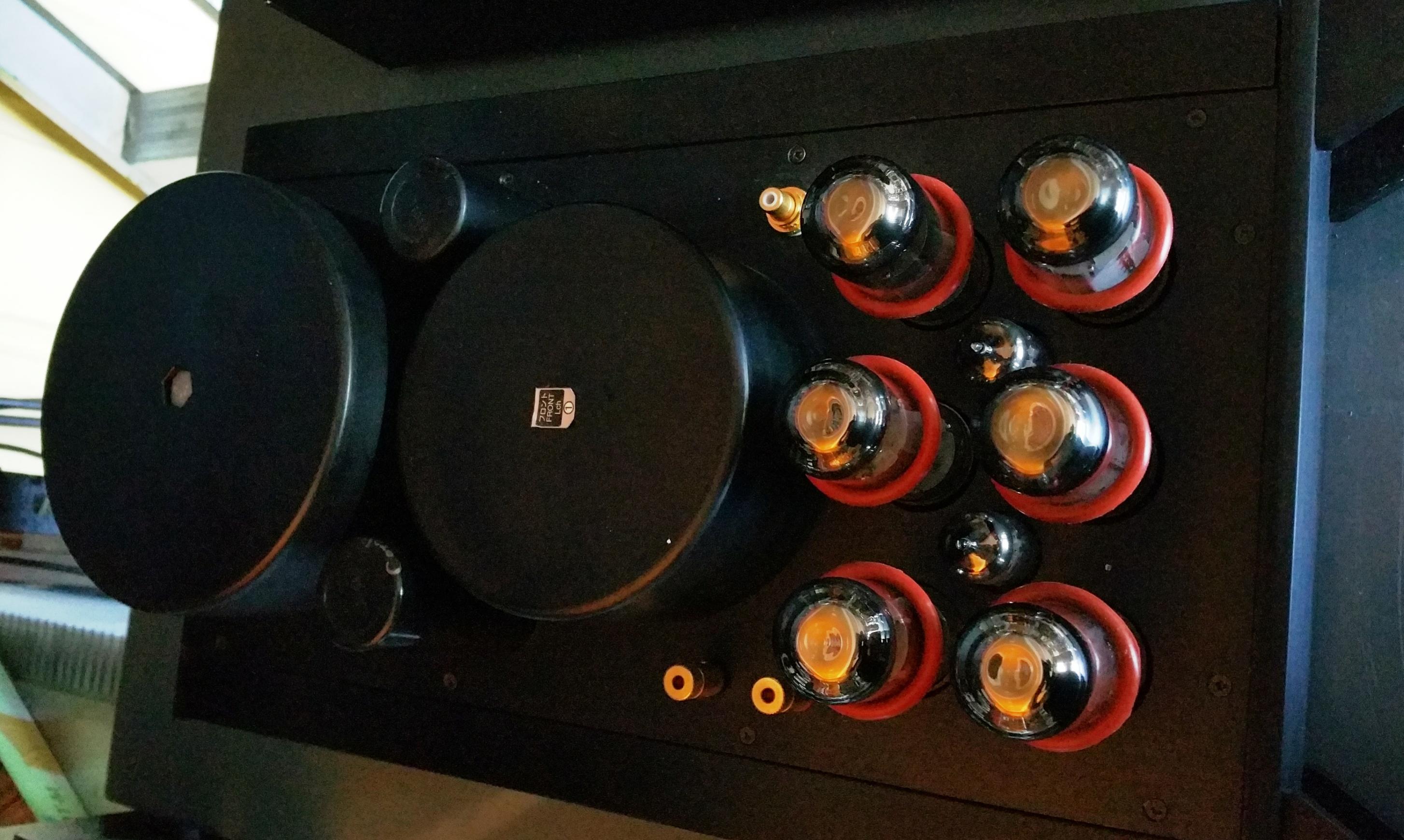

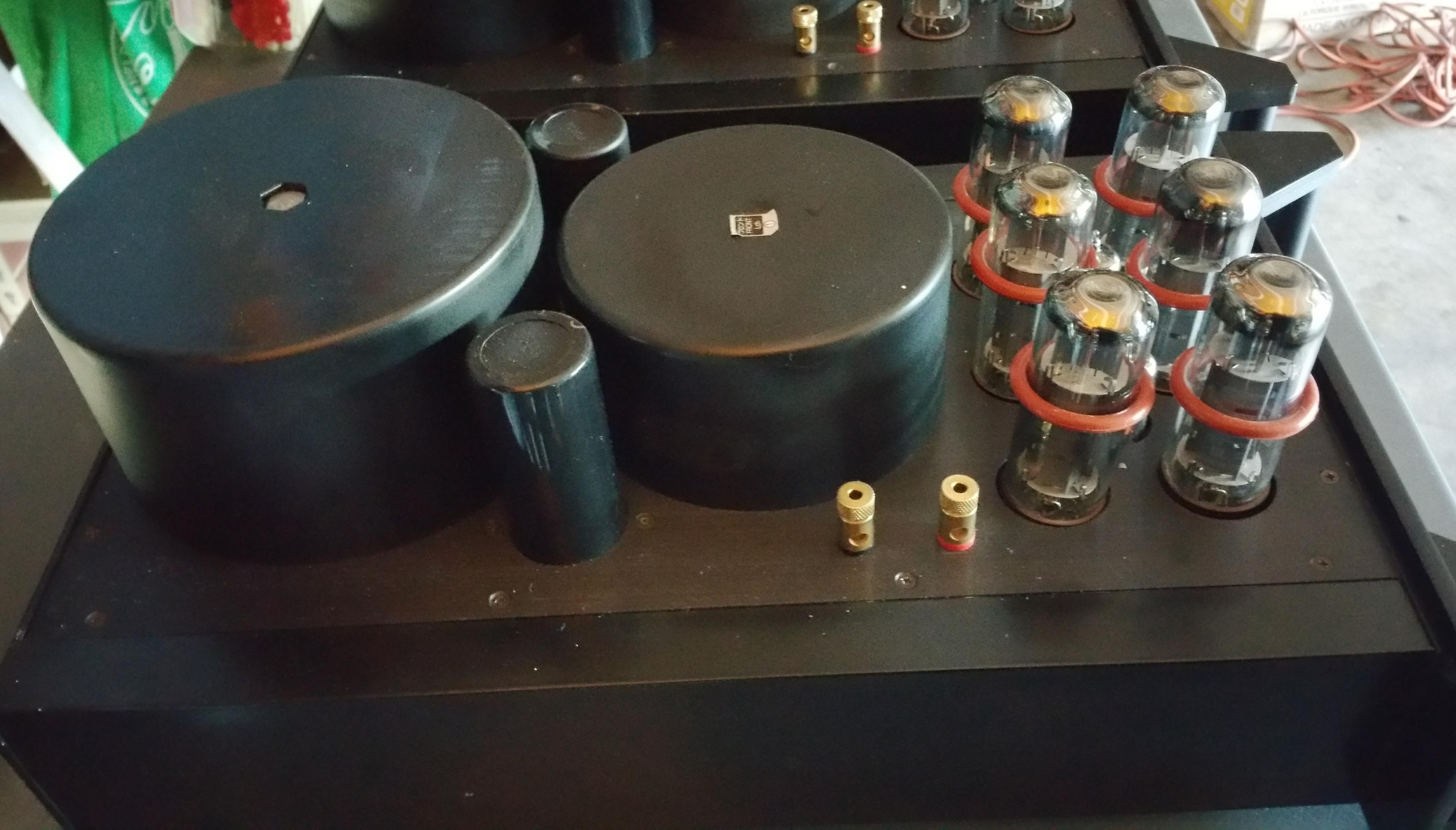

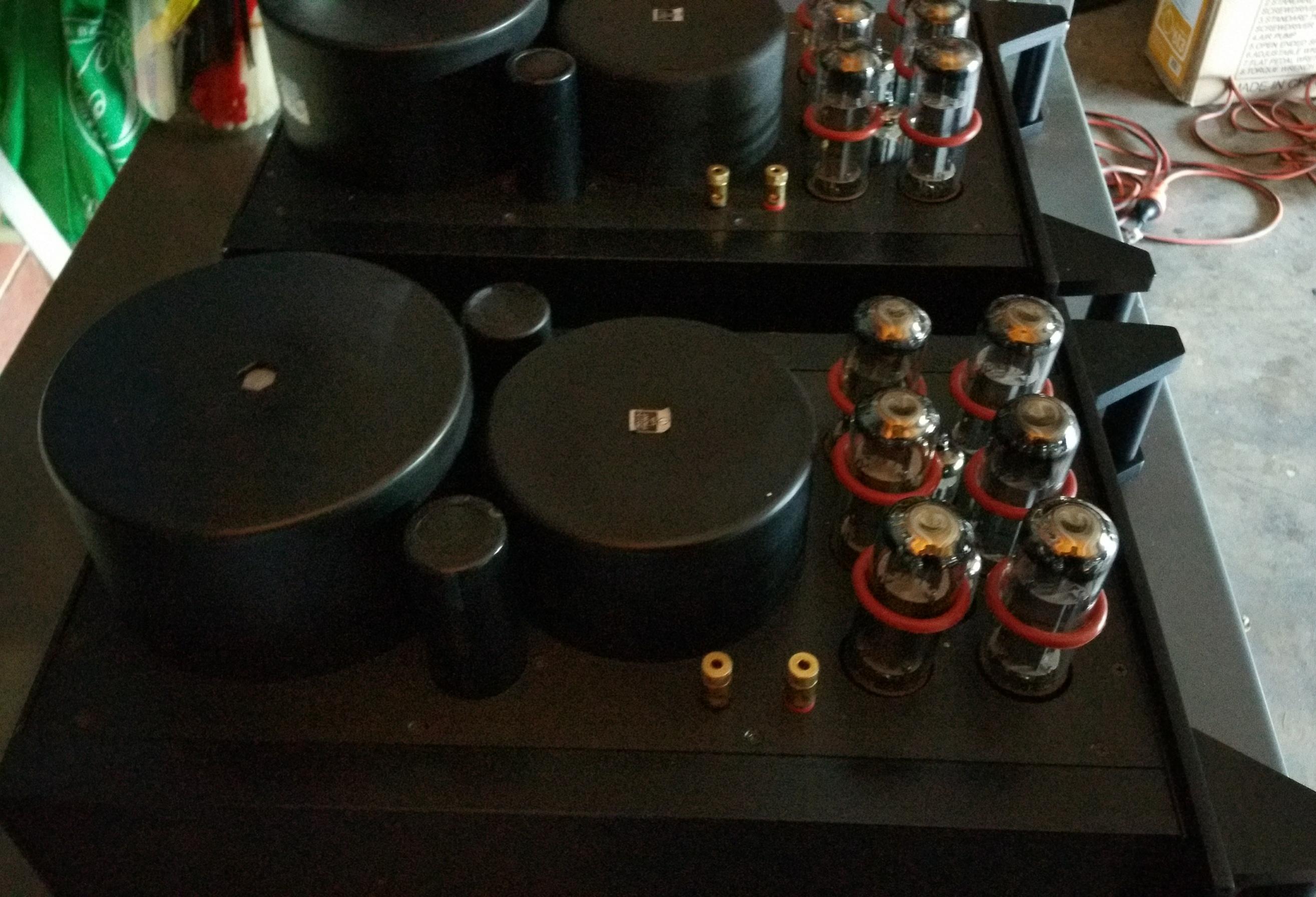

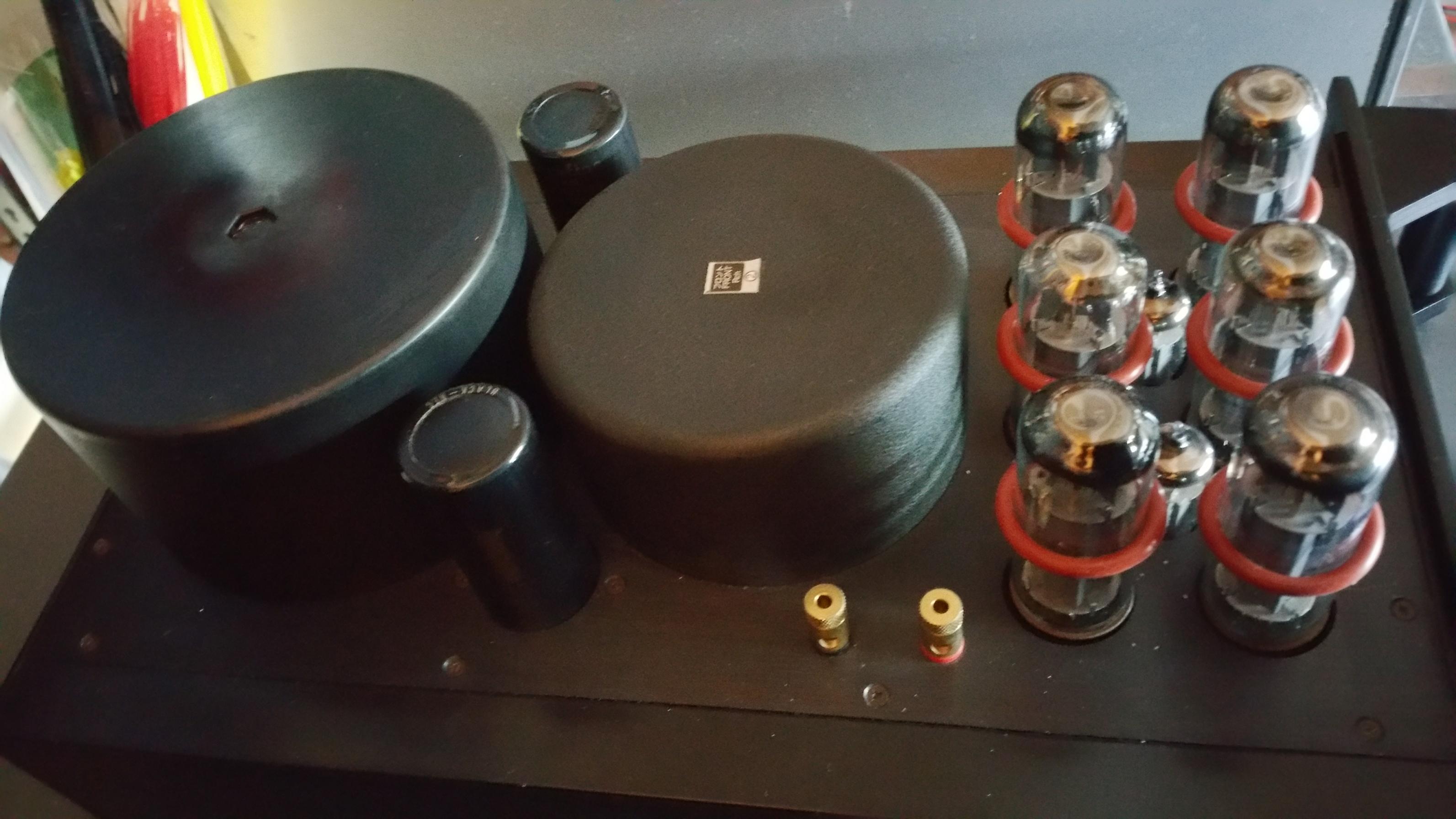

Hello all.
Need some help here in identifying these amplifiers.
I recently purchased these from a Sydney seller and one can clearly see that they have been home built.
My gut feel is that they were made in Australia.
I would very much like to find out, if possible, who built them (so I can badger them with lots of questions!!!)
They are reasonable well made, and with each amplifier running 2 x 6NS7 and 6 x EL34.
What is interesting, is that the main circuit board holding all the tubes looks to be of commercial quality, being sully silk screened, solder masked and plate through holes. The rest is hard wired.
Transformers, both power and output are Plitrons.
If you can help, I would be very grateful to hear from you - Perhaps you recognise the casework?
PS I will post some internal pictures tonite.
Kind Regards
George.

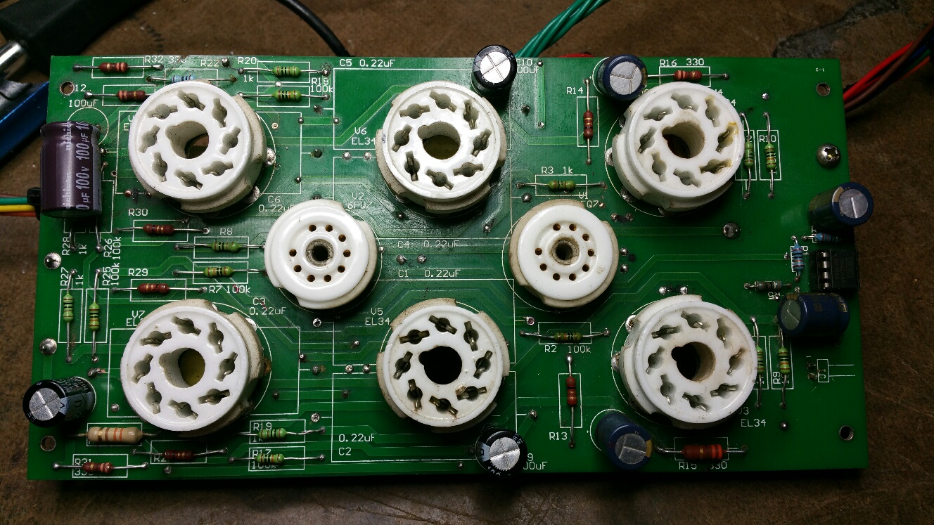

Hello again.
These amplifiers continue to be a source of frustration. Main issue is stability, and difficulties in biasing, and maintaining bias.
Over the past few nights, I have managed to piece together a schematic from the PCB, which was not an easy job, considering its double sided, and fully populated.
Further to my original post, herewith is a picture of the actual PCB.
Once again, I am hoping that someone recognises it, and can help me identifying the maker / designer.
The PCB is definitely of commercial grade.
If there is anyone that knows where it came from, please let me know.
Kind Regards
George
VK5ZG
PS: My sincere thanks to Ian - “Gingertube” from this site, for all the assistance he has given me to date.
The tubes are too close. The input tubes should not be in between the output tubes (HF feedback and heat). The PC traces are rather close for HV.
I don't see any trimpots for biasing the output tubes. Their appears to be an Op. Amp. chip, maybe some kind of auto-bias circuit. That still would not handle differences between the tube triplets though, unless there are some current sharing cathode resistors. Someone probably got tired of ordering matched triplet tubes. That many tubes in parallel may require some VHF parasitic absorbers (R L) in the plate circuits too.
Hi Binary & Smoking.
I agree with both of your comments.
With respect to the PCB, whilst very well made, the layout in my opinion is quite poor, with traces literally running from one side of the board to the other just to pick up another component.
There is a separate PCB with a simple PSU for the bias supply, and this also contains the trim pots for bias adjustment.
The op amp, BB OPA2134 feeds the 6CG7 triodes at the input. Must say I have not seen this before.
I have managed to sketch out the schematic, but it still needs checking and to be properly drawn up.
I will post it as soon as I have cleaned it up
Thanks you all for your assistance.
Cheers
George.
