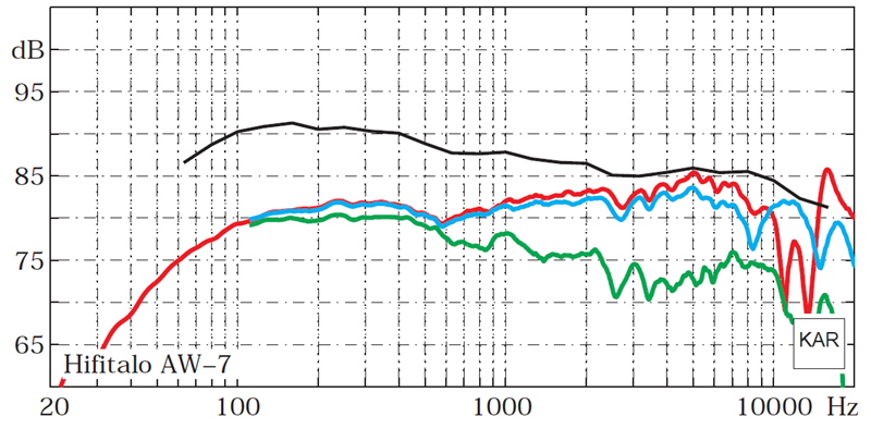

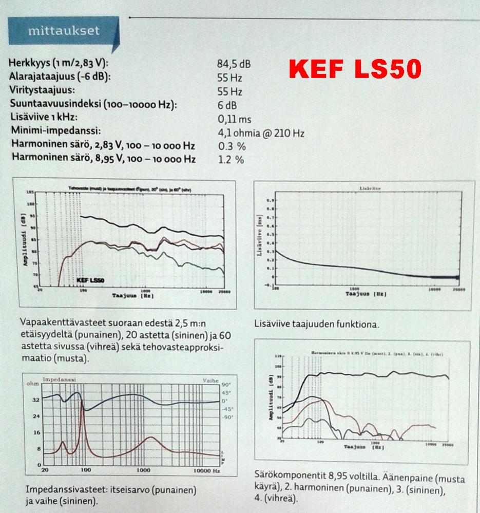

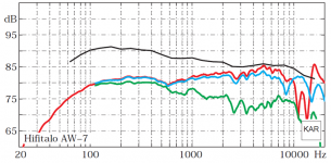

Here's a couple of John Atkinson's measurements. The first is from the Gradient Helsinki, the second is from the Kef LS50 (which is also very good IMHO.)
I believe that the waveguided tweeter and the midbass in cardioid enclosure could be replaced by an LS50 UniQ unit in a cardioid enclosure without any significant difference in the end - ie. sonic - results

Kef LS50 was measered for a Finnish magazine. The power response was calculated from anechoid chamber measurements. Not the best I have seen. For comparison same measurement from a SEAS coaxial application
The cardioid has somewhat narrower directivity at 500 Hz and is probably more immune to the front wall. But in my experience a cardioid makes the biggest sonic difference compared to a closed box if it is used down to about 100 Hz, which they did not do unfortunately.
