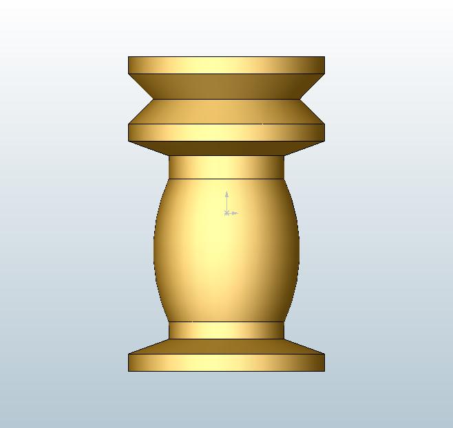

Here is what I have so far. We need a tight tolerance 3mm bore. Center drill, drill, bore to diameter. For the outside profile. I have no experience designing a drive for a flat belt. Do people want a flat belt drive? I was originally going to do a simple 45deg V groove for a square belt. I have an MMF 7 at home that I will check the pulley on and verify what the profile looks like. I will try and whip something up tonight and run it past those who are interested.
On another note, 17mm Diameter at the inside of the groove will be 17 mm this should get us in the ballpark RPM range.
DaveM

DaveM said:Here is design idea #1. This should work for everyone. Although it may not be asthetically what everyone wants. Please give me feedback.
Dave
I'm not sure that the pic will post, but I am trying.

Your image opens up nicely.
That looks good.. somewhat like the pulley on the bix turntable. I really want to have the possibility of choosing between a flat belt and a thread belt. I thought the other pulley didn't have the option for a thread belt.
Make it have the dimensions as recommended earlier in this thread, and out of brass, and I would really want it. Plz make it
The dimensions on that design are 17mm diameter to the bottom of the V groove and to the top of the crown as well. With the flexability of the motor control it shouldn't make much difference give or take a little bit.
What are people's feelings about set screws or not. If people are happy with using thread lock to hold this on, my life will be a bit easier. If we need set screws, I will find a way to make that happen, but the cost will jump as payed labor will now be involved.
Input?
DaveM
