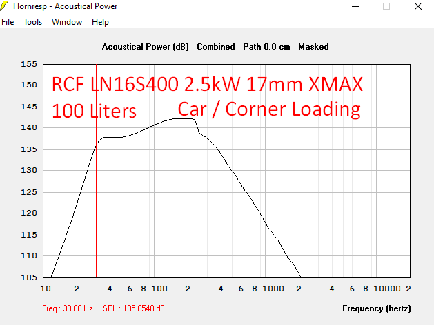

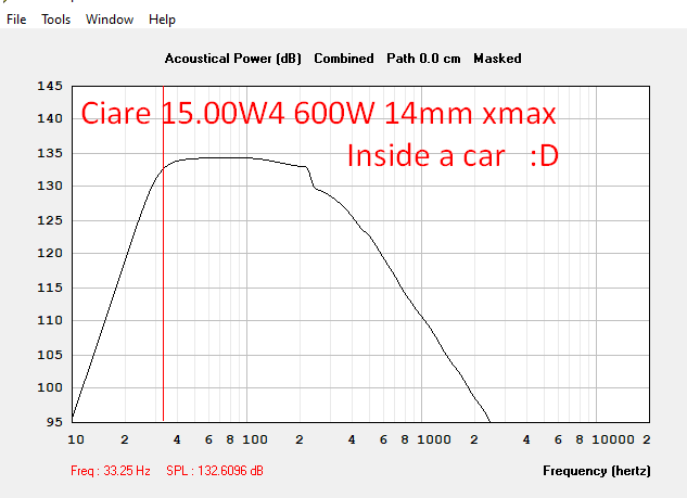

A car with a powerful bass box and a few kw is effectively a huge 10 m3 8th order BP with a 12 m2 passive radiator-port tuned to 40 hz

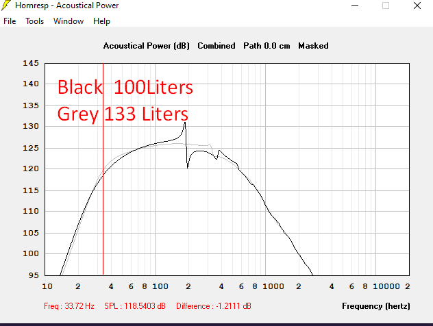

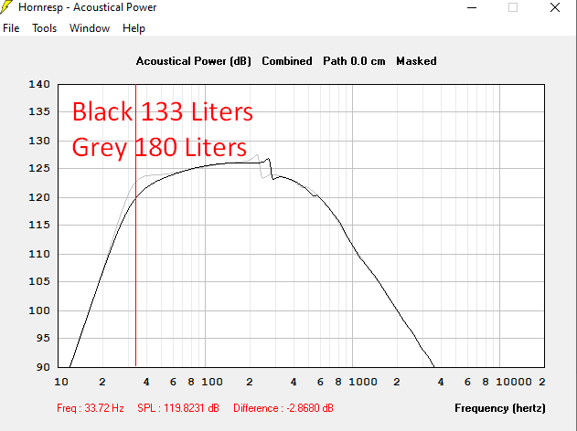

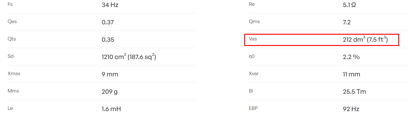

on the BC site ,Vas for the 18TBX100 is 212 litersRandy Said:It's much cheaper than the 12W7 and goes low. Looks to offer the size of output down low that I am after but can this work in a 80-100L 33Hz ported box? It just might be the high power driver that I am after
looks like the 18TBX100 don't like stuff smaller than 134 liters
at 100 liters theres a nasty spike
comparing 133 vs 180 Liters you can see that 180Liters is 3dB (2.8dB to be exact )
more efficient than the smaller enclosure
and 3dB is like doubling your power
1st pic shows nasty spike at 100Liters
moving to 133 almost get rid of it
2nd pic show the advantage of a matched Vas
almost 3dB more efficiency
