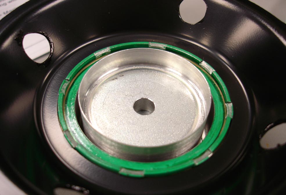

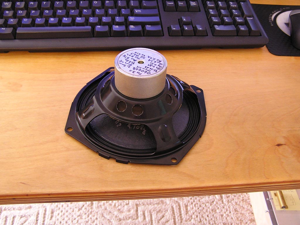

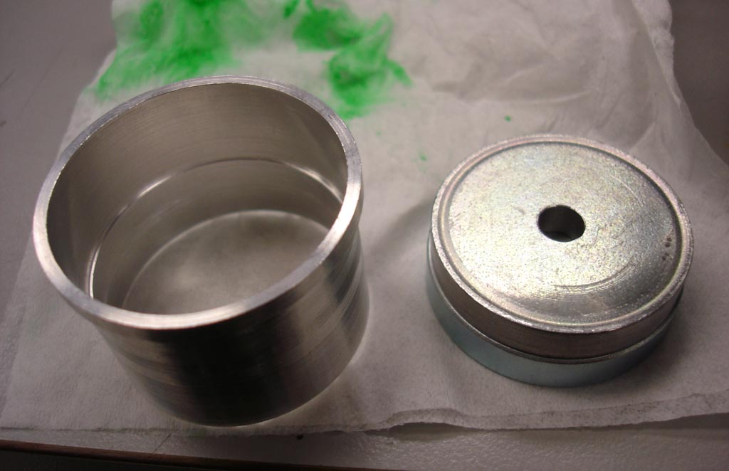

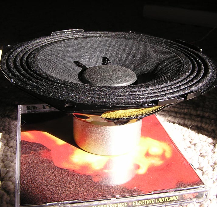

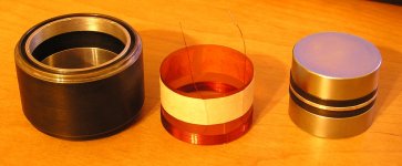

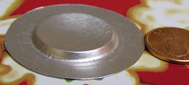

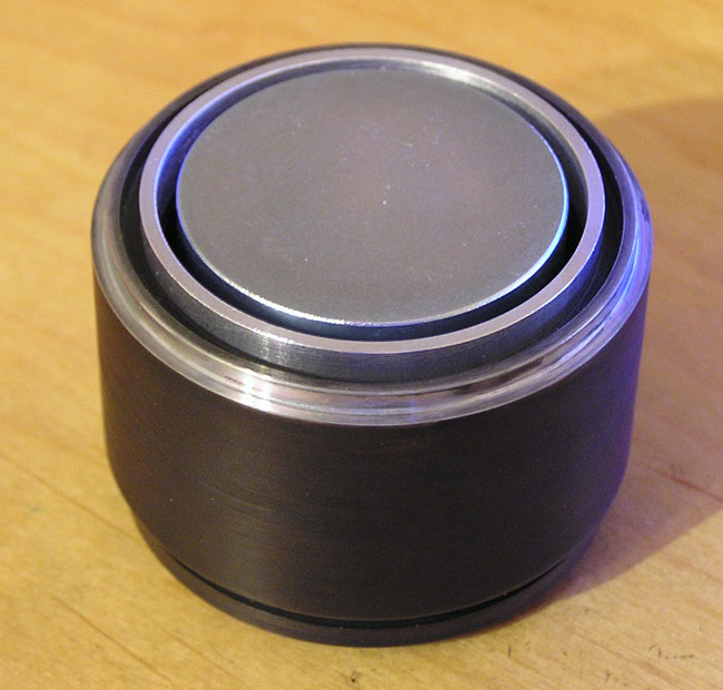

I was working on some of my own drivers several years ago. I attached some pics. I keep moving though and it slows me down.
Speaker dave is right - it is pretty easy to assemble a driver. I helped build thousands at my last job and after you do a couple it is pretty easy. It's having the parts. If you don't have a pile of parts you want to use, then you have to do all the design work from scratch which takes a long time if you are trying to hit a particular set of parameters. Then if you're doing it all yourself, designing the tooling is potentially just as long a process if you haven't done something just like it before.

Hi David,
They are center neo magnet structures. In some of them (like the 5th and 6th pictures), I have an additional top neo magnet with the opposite magnetic polarity. It's supposed to increase the flux in the gap, and it also changes the shape of the flux field. However if you design it wrong, the top magnet will repel and potentially violently remove itself from the speaker after you think you have it nicely glued in place.
