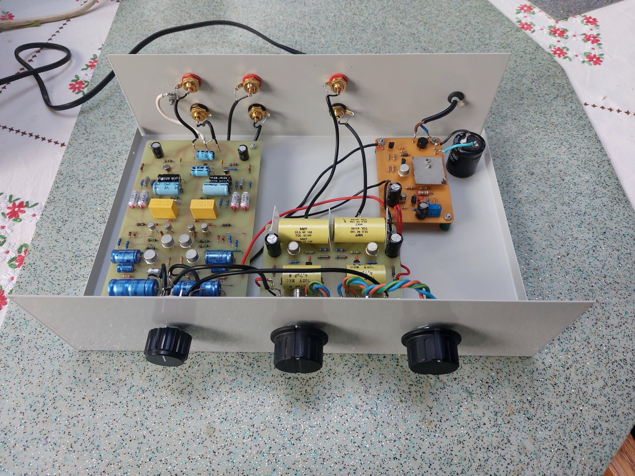

For some further refinements you can check out my 3 transistor design. It uses some more refined input biasing that gives better PSRR (at the cost of adding one resistor and capacitor per input), and the more sensitive and not very current-hungry input amplification circuitry got its own little RC power filter that doesn't have to feed the output buffer. One thing I never really got worked out entirely is the matter of turn-on thump. The output necessarily has to rise to about half supply or around 24 V in this case. It works out OK if I use a 2µ2 output capacitor and 10k of pre-loading, but I'm not entirely happy with that. Perhaps going 2nd order would help, otherwise a delay / muting circuit may be required. This really is a drawback of just about any single-supply circuit if you also want some serious low-frequency extension
