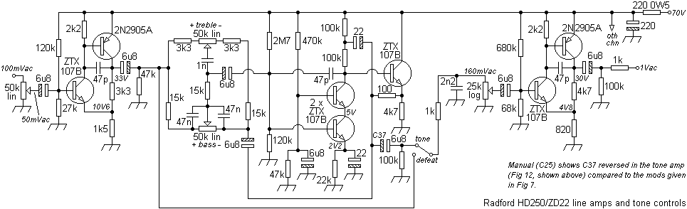

Hi ! i am very interested in this topic. Looking at the schematic do you think that a portion of the circuit can be used as a high performance line stage preamp ? or even just as buffer for a good quality attenuator ? I am obsessed by "minimalistic" line preamps ... for me it is the center of the audio system. The good ones are very expensive i understand.
Back on topic i have some doubts about the schematic of the zd22 preamp
I see 3 sections: - input amplifier with pot - phono stage - output amplifier with pot
Why not increase the gain of the phono stage and do with just: - phono stage - output amplifier with pot
Then i have other questions. If excellent THD+noise figures can be achieved with simple/basic/text book design why the need of more complex designs? and moreover ... what is the limit of performance of an already very good simple design ? maybe optimizing voltage and parts selection ?
The zd22 is an old love of mine ... and i will end very probably with using its optimized output stage (lowering its gain) as a base for a line preamp to be put just after a very nice passive attenuator (this is an open issue).

Leaving aside the phono, I see:
- input level control (dual)
- CFP emitter follower buffer
- Baxandall tone control stage terminating at gain stage with CCS giving 5x gain
- volume control (dual)
- another CFP buffer.
I guess these days we would dispense with one of the volume/level controls and use an active gain stage. But if you want a virtuoso exercise in simple discrete design, this line stage board is it. 67V rail, CFPs instead of emitter followers, CCS gain stage. Very low distortion, and one of the best sounding preamps I've ever heard.
In the examples I've seen the 120K lower arm of the voltage divider is replaced with a 6V2 Zener.
... if you want a virtuoso exercise in simple discrete design, this line stage board is it. 67V rail, CFPs instead of emitter followers, CCS gain stage. Very low distortion, and one of the best sounding preamps I've ever heard. In the examples I've seen the 120K lower arm of the voltage divider is replaced with a 6V2 Zener

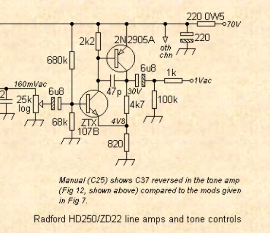

Hi ! are you referring to a specific project ? maybe i understand wrong ... but the CFP provides gain already ... what is the CCS gain stage ? To explain i was thinking at using the output stage only for line preamp duties ... maybe optimizing it in terms of gain and distortion ... (i really do not need V gain of 6 times) Some time ago i tried to sim the output stage but i would like to select the best bjts for the task first, among those now available ... and with their models for sim ... just to play with SW before actually solder I guess modern parts should outperform the old original ones ... a friend of mine went further building a little prototype on perfored board ... he was impressed by how the sound changed with feedback resistor then he moved to tubes ...
So, what do you need then? (In terms of gain, noise, source impedance, load impedance and levels.) Eventually you'll start running into problems at low gain with this circuit, with noise possibly not being as low as you may like. At some point you start having to add an output pull-down resistor or current source.

A key to the good performance of these rather simple circuits is their high supply voltage. It saves you the odd current source (while still allowing high loop gain) and keeps Cob low. The downside is that some desirable parts top out at 45-50 V C-E and may require cascoding.
For some further refinements you can check out my 3 transistor design. It uses some more refined input biasing that gives better PSRR (at the cost of adding one resistor and capacitor per input), and the more sensitive and not very current-hungry input amplification circuitry got its own little RC power filter that doesn't have to feed the output buffer.
One thing I never really got worked out entirely is the matter of turn-on thump. The output necessarily has to rise to about half supply or around 24 V in this case. It works out OK if I use a 2µ2 output capacitor and 10k of pre-loading, but I'm not entirely happy with that. Perhaps going 2nd order would help, otherwise a delay / muting circuit may be required. This really is a drawback of just about any single-supply circuit if you also want some serious low-frequency extension.
