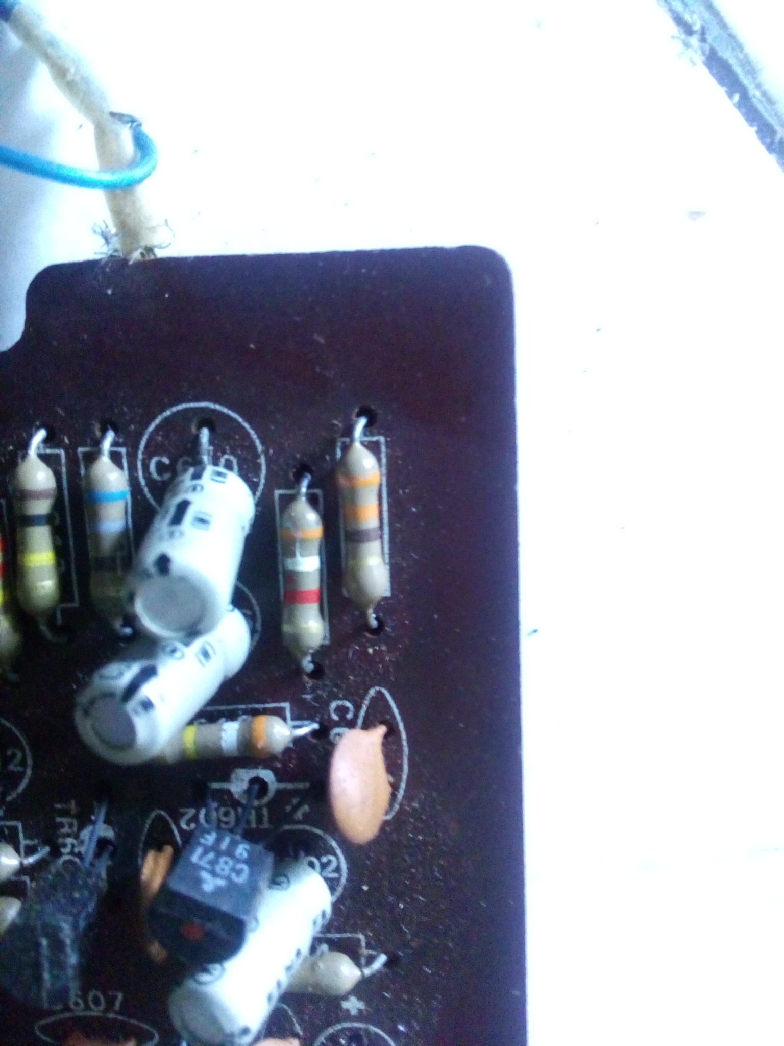

Those resistors are ±10 % tolerance as indicated by the silver tolerance band at the end. It's been quite a while since ±10 % was used in mass production so I'm thinking these resistors are probably generic carbon film resistors. You can replace them with anything. I'd go with metal film these days, but, honestly, any resistor will do for those. I don't know which company manufactured them but I hope this information is helpful to you.

The old resistors people often like is carbon composite resistors. They're quite awful actually. They have high 1/f noise and high excess noise. I'd imagine their temperature coefficient and possibly voltage coefficient are pretty horrid too. But that doesn't stop people from seeking them out.

On my monitor, the tolerance band looks gold, which would make them generic carbon film resistors with 5% tolerance. From the size, I think they are 1/4 Watt types. They should be available from any parts vendor, and they are about the cheapest leaded resistors you can get. They are made by many manufacturers and they all look more or less the same, so it is impossible to exactly identify them from a photo. However, any 1/4W carbon film resistor should be just fine.
As others said, these are carbon film resistors, typically used in equipments from Asian origin, like Hong-Kong, Taiwan, etc. during the late sixties and the seventies.
They are generally OK, but not very stable or accurate, and have a non-negligeable excess noise, which is of no importance in most cases.
More annoying, they can sometimes fail open, especially when voltage or heat-stressed
