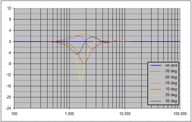

However at risk of making a fool of myself I think you have a mistake, or at least an ambiguity in your Butterworth 3rd order results and graphs.
In the first Butterworth 3 "drivers in phase" graph you show that the notch occurs at 30 degrees, while the 3 dB hump occurs at -30 degrees.
However, you don't state at all (unless I missed it) whether this was calculated with the tweeter above or below the woofer, and this will obviously reverse the result, since the relative change in phase with vertical off axis movement will be opposite. With an even order filter it doesn't matter, but with an odd order it does.
Lets assume for the moment you meant for it to be with the tweeter above the woofer, the most common situation.
The next slight ambiguity is that you don't state explicitly whether positive degrees off the vertical axis (in your graphs) represents a listening point which is higher than the equi-distant design axis.
Again I would assume so as it makes sense to me to use positive angles for listening positions above the design axis, and negative values for listening distances below the design axis.
If we make both assumptions - positive off axis angles represent a higher listening position, and the tweeter is above, you seem to have your graphs back to front. A higher tweeter and a positive phasing between drivers should give the 3dB hump above the design axis, and the notch below the design axis.
Consider the relative phase shift of the drivers on the design axis for in phase connection - at the crossover frequency (-3dB point) the woofer has -135 degrees phase shift (lag) while the tweeter has +135 degrees phase shift. (lead)
Therefore the tweeter is +270 degrees ahead of the woofer, or another way of looking at it is -90 degrees behind. 90 degree relative phase shift summed together gives a gain of 3dB thus resulting in flat on axis response.
If we now move the listening position vertically up the distance to the woofer increases more than the the distance to the tweeter, thus more phase lag is added to the woofers response relative to the tweeter.
If we normalize the phase change between the two drivers (since only their relative phase matters in working out how they sum) then at some positive vertical angle (which also depends on distance) the Woofer lag will be -180 degrees, while the tweeter lead has increased to 180 degrees, total phase shift is now 360 degrees or 0 degrees, so there will be a 3dB hump.
Reversing the phase of one driver will swap the notch to be present in the positive angle range and the hump at negative angles. Reversing the physical position of the tweeter and woofer will also reverse the positions of the hump and notch, so both reversed drivers and reversed phase will bring us back to the first situation.
Am I wrong ? 🙂

You're right - I forgot to list some aspects of the model in the white paper, so let me list them here:
MODEL SYSTEM DESCRIPTION:
drivers are point sources in an infinite planar baffle
the tweeter is located above the mid/woofer
"on-axis" position is half way between mid/woofer and tweeter
off-axis angles > 0 are considered to be "above" the on-axis plane
Regarding your question about whether the off-axis responses in my plots are "back to front", I believe that what I have shown is correct. I re-checked the math by manually redoing a calculation of the relative distances from the drivers to the observation point and got the same result.drivers are point sources in an infinite planar baffle
I did all of this in Excel, using formulas only, just as you suspected. I used Excel's complex number data type so that I can calculate everything in the frequency domain before calculating amplitude and phase at the end, as the magnitude (Excel's IMABS function) and phase angle (Excel's IMARGUMENT function). I like this approach, and I have used it several times in the past to work up acoustical models.

Hmm, are you sure ? If so, can you spot a problem with my "back of an envelope" analysis of how the relative phase changes with position resulting in lobing ?Regarding your question about whether the off-axis responses in my plots are "back to front", I believe that what I have shown is correct. I re-checked the math by manually redoing a calculation of the relative distances from the drivers to the observation point and got the same result.
I have to say that I'm surprised, because I have a speaker that uses an 18dB/oct butterworth crossover between midrange and tweeter, (at 4Khz) with both acoustic centres aligned, and I specifically chose to have the drivers in phase so that the first cancellation axis was below the horizontal axis rather than above. (With tweeter above midrange) It's pretty clear from measurements (pink noise etc) that the nearest cancellation axis is indeed below the on axis position.
Unless I have an error in the order of 43mm in measuring the acoustic centres of the drivers (which would be 1/2 a wavelength) I can't see how it could be otherwise.

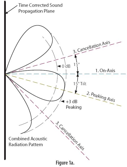

Also, I reproduced Figure 1a from the "Linkwitz-Riley Crossovers: A Primer" Rane document using my spreadsheet. This is shown below, with the Rane figure for comparison, for the same conditions:
1700Hz crossover point
Both drivers connected with the same polarity
7 inches y-offset, z-offset = 0 (e.g. what Rane calls "Time Corrected" in the figure)
Again, the polar plot shown by Rane and the plots that I am generating are presenting the same data, just in different ways. If you look at the -10 degrees and -20 degrees response curves (dashed) at 1700 Hz on my plot, you can see that they peak at nearly +3dB. In the Rane polar plot, the 3dB "peaking axis" occurs at -15 degrees, so -10deg and -20deg are straddling the peak. Similarly, at positive 10 and 20 degrees in my plot, you see a partial null. These two angles straddle the "cancellation axis" in the Rane plot, at +15 degrees.
Again, since Rane didn't state which driver was "on top" this is only direct evidence, however I would assume they chose the normal "tweeter on top" setup.

Simple trigonometry says otherwise. The angle required to get a given physical time delay (thus phase shift) between two vertically offset drivers is different up close than it is far away - eventually stabilising on a minimum angle at far distances, depending on how far apart the drivers are.I thought the phase relationship was the determining factor, not actual time delay difference. Once a phase relationship between the drivers is established by the physical position, that relationship will not change with distance, unless one driver's sound travels at a different velocity. 😉
If you take the "virtual acoustic centre" of the two drivers as being the vertical half way point between the two drivers actual acoustic centres (at the crossover frequency) the angle of cancellation measured as an angle relative to that half way point changes with distance.
A worked example: (bear with me, as it's hard to describe without a diagram) Two drivers with a vertical offset of 20cm centre to centre. Two microphone listening distances, one of 0.5 metres, one of 5 metres. On axis the time delay between the two drivers is equal at both distances, obviously. You have two equal and opposite right angled triangles represented.
Now tilt the position of the microphone 15 degrees on the speakers vertical axis pivoting around the half way point between the two drivers acoustic centres, our "virtual acoustic centre".
Now work out the distance to each drivers acoustic centres from 0.5m and 5m from the "virtual acoustic centre" on the new 15 degree measurement axis.
We can work out the height and distance for the microphone for 5m from the virtual acoustic centre point with trig - the vertical offset is 129.4cm, while the horizontal distance from the line formed between the two driver acoustic centres becomes slightly shorter, at 482.96cm.
Now we know the exact position of the microphone we can work out the distances to each drivers acoustic centre.
For the top driver the distance is 497.50cm, and the angle is 13.89 degrees. For the bottom driver it is 502.68cm and the angle is 16.1 degrees. The top driver is nearer to the microphone than the bottom one by 5.18cm.
Now if we repeat the calculations for a nominal measurement distance of 0.5m. The vertical offset of the microphone is 12.94cm and the horizontal distance from the line between the acoustic centres is 48.296cm.
So from the microphone to the top driver we now have a distance of 49.999cm, and an angle of 3.48 degrees, and to the bottom driver we have a distance of 53.467cm and an angle of 25.41 degrees. The top driver is nearer to the microphone than the bottom one by 3.468cm.
What this means is the relative phase shift between the two drivers is significantly different at 15 degrees off the vertical axis measured at 0.5m than at 5m. As you get further away and the driver separation becomes smaller relative to the measurement distance the effect diminishes.
If you were to work it out the other way around - the necessary angle to get a certain phase shift, (to find the angle of cancellation for example) you'd find up close you require a steeper angle to get cancellation, but a shallower angle at further distances, with a steady angle by the time you reach infinity.

So, how can this be compared with my result? The power response that he plots is just a "slice" through all off axis angles for a fixed frequency (he chooses the crossover frequency). My plots are frequency response for a select number of off axis angles that illustrate the off-axis behavior within some window of "on-axis". If you stay at the same frequency on my plots, each of the off-axis FR lines that cross that frequency represent a point on John's polar plot.
Once you think of it that way, you can see that the +3dB lobe is "above" the on axis and below is the null, both in John's way of plotting the data to highlight polar response and power, and my way that highlights frequency response.
You'll notice that the 1st order crossover has it's lobe in the opposite direction from the 3rd order - because the relative phase shift of the two drivers is opposite to the 3rd order case. -45 degrees lag on the woofer, +45 degrees lead on the tweeter, means the tweeter is 90 degrees ahead of the woofer, and as the second reference of mine you reposted points out "the peaking axis tilts towards the lagging driver." (Because moving closer to the lagging driver and away from the leading driver moves closer towards the two being in phase with each other, leading to coherent addition and 3dB of gain)
The first article you reference also says "The flipping of the polar response for the Butterworth crossover [between orders] is normal and can be inverted by altering the polarity of one driver", which to me says that the polar responses were taken with in-phase driver connection.
As you say, in this reference they didn't state which driver was on top, nor did they state the phasing of the drivers. (Or even which way is up in the polar diagram)Also, I reproduced Figure 1a from the "Linkwitz-Riley Crossovers: A Primer" Rane document using my spreadsheet. This is shown below, with the Rane figure for comparison, for the same conditions:
It's somewhat common practice though, to connect a 3rd order butterworth filter with one driver out of phase - because the total phase shift is only 180 degrees vs 360 degrees of the in phase case. (Personally I don't do this, and prefer the in-phase connection for other reasons)
What they do say though, as I mentioned last time is "The peaking axis tilts toward the lagging driver in both cases, due to phase shift between the two crossover outputs.", and then leave it up to the reader to determine which is the lagging driver.
The 1st order butterworth case is nice and simple - the woofer is the lagging driver, lagging by 90 degrees, so the peaking axis tilts towards the woofers side. The first reference you provided clearly shows that the peaking axis swaps between 1st and 3rd order butterworths (the tweeter is 270 degrees ahead, eg 90 degrees behind) and so in this case the peaking axis tilts towards the tweeter.
I was slightly unsure of my position when I first posted but reading the various references and working it through in my head a few times has only made me more certain that I'm right. I'm still sure you have your vertical off axis angles reversed.
