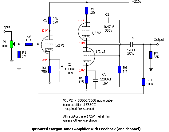

Hi folks,
I have been searching for an answer to the following question:
What is the purpose of a cathode bypass capacitor in a White Cathode Follower buffer?
My rather limited understanding of tube-land would indicate that a cathode bypass capacitor is employed when the is a need for gain augmentation and/or output impedance reduction.
If I remove the cathode bypass capacitor in the following circuit, would I need to pay attention to any other component values?
My goal is to mostly drive low impedance cans.
Specifically, a 38Ω load (Sivga Luan pair of headphones).
My higher impedance cans will be driven by my other amps, so I don't really need for this Morgan Jones mini-tube headphone amplifier to be compatible with cans above 60Ω.
Anyway, back to the original questions:
A. If I remove C3 completely, do I need to consider altering any other values in the circuit in order to not upset the balance of the WFC?
B. What's the 'mystery magic' of having a cathode bypass capacitor in what's essentially a unity gain buffer?

The "bottom" half of V2 is fed current-sensing positive feedback via C2, so its contribution to total output will be changed if cathode degenerated. Into a high impedance load this would amount to R5 in series with reciprocal of Gm (maybe 100R-ish) instead of just the 100R-ish. Into an almost dead short 38R, who knows? LTspice could probably guide you, but why do it?

R4 is quite close to the reciprocal of Chris's estimate of the transconductance of the bottom triode. The only reason I could think of why this is so, is that the output triodes are supposed to work in push-pull. In that case, R4 has to be increased to 390 ohm when C3 is removed.
Or, one could say that both halves operate in parallel. When I asked "Why do it?" I really meant "Why try to drive 38R with a button base receiving valve intended for small signal operation?" Just seems Quixotic.

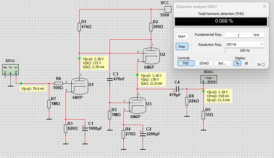

Hey, I've been kicking this circuit around a bit myself, the original MJ circuit is not really suitable for the low-Z headphones. Check the article on Headwize, they explore options to lower the output impedance. I also floated this question over on the Headphone sub and got someone to model an interesting version using 6N6P as outputs. Higher current drives 35R easily.

One issue I have with the original circuit is the fact that P1 and the input source are part of the negative feedback loop. You will have different nFB levels depending on P1 position.
Hi, what is an app you use for Spice simulation? I use LTSpice but your is something else...Hey, I've been kicking this circuit around a bit myself, the original MJ circuit is not really suitable for the low-Z headphones.
You'll have to ask @lineup he was kind enough to whip up a schematic in Post #16 of This thread over on Headphone Systems.

Merlin, I'm totally fine with slightly higher output impedance.I cover this in my book. The bypass cap does reduce output impedance a bit, not a lot. However, I recommend not bypassing the cathode, because the WCF has atrocious overload recovery/blocking distortion when it is included.
