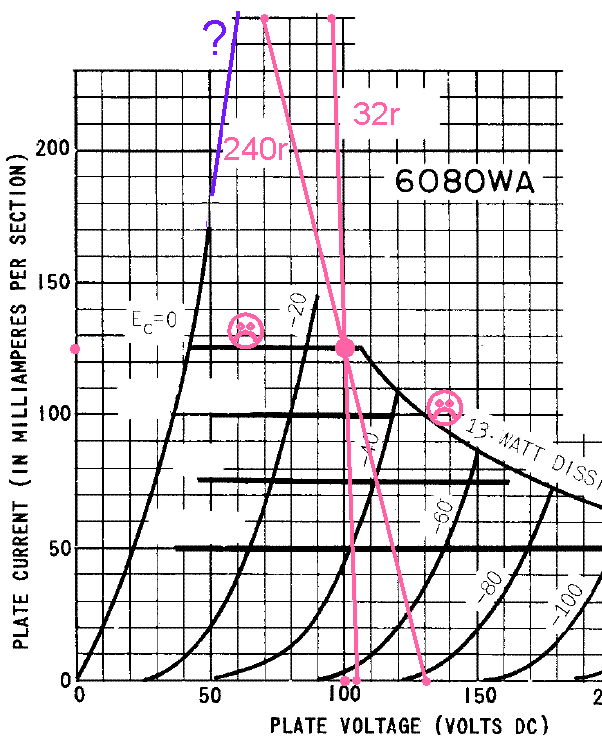

My DC biasing test circuit:
6AS7-G curves:
Common cathode amplifier can be designed using load line technic. But how to design cathode follower properly? Especially the White's one. How to choose proper supply voltage for example? In many articles I've read design procedure starts with some predefined supply voltage.
Idle current is an easier aspect. Lower tube works as voltage controlled current source so idle current can be adjusted by changing it's working point. On the other hand upper tube's grid voltage depends on this current in quite complicated way. In MOSFET source follower, for example, Vgs depends on current too, but local feedback always pulls it close to Vth. Tube has no Vth concept. Thus it gives us another question: how to calculate follower's grid voltage? And how to deal with it? Should I make it as low as possible, because lower voltage gives us more transconductance?
6AS7-G curves:

OK. This job the "Boss" (you) has instead specified a 6080/6AS7, but not even suggested a voltage. So you see what a 6080 is. Max Pdiss is 13W. Max DC current is 125mA. Put marks on these lines. Let us blindly put a dot at that point. Or round-over to 100V 125mA for a neater graph and 4% lower heat.
WCF stacks two tubes, each working similar, we double the total supply voltage.
So far we have 200V supply at 125mA, but have not accounted for bias.
We can swing above 125mA as long as we swing under. However we do not want to cross the Zero Grid line (without more thinking). Tung-Sol didn't plot over 170mA. I've guesstimated the zero-grid line higher. This is not for-sure, something to check later.
Plot the load-line. Dang, Merlin is right! 32 Ohms is essentially vertical. 240r has less slant than my wood-shed wall. We normally want a load to "fill a diagonal, corner to corner", or as near to corners as tube losses allow (mostly that zero-grid is still significant voltage drop, and cut-off is elusive).
Innerestingly we appear to clear the zero-grid line.
To get 30V peak in 240 Ohms we need grid swing of -28V idle up to -5V and down to -80V. 23V one way and 52V the other way promises HIGH 2nd harmonic distortion. True push-pull would cancel that. The WCF runs out of push-pull-- as the upper tube cuts-off, the lower tube loses drive. Or in this case, we just can't reasonably swing the top tube into cutoff (without a wicked asymmetric drive or massive overall NFB). Just taking the up-swing, as a follower we need 30V in load plus 23V of grid swing to get 30V out. Gain is 0.57, far short of unity. Yes, the WCF connection may improve this. But since it is a poor follower, we may suspect it will be poor even with another tube's help.
In 32 Ohms we get 4V out with 5V grid swing. Gain is 0.44, a little worse. That the gain does not drop so much for 8X heavier loading is a sample of the WCF's magic. But it still strains.
We "violated" the 125mA line by assuming we will swing both-ways around that. It now appears we will swing-up more than we swing-down, so the average current rises. (True of most tube amps.) In full power testing we will exceed ratings. In un-clipped speech/music, I would not worry about it (yet).
4V peak in 32r is 250mW, which seems ample. I do suspect the distortion will get quite terrible before it reaches 100mW, and some folks want that much. The 240r output computes as over a Watt. If this seems over-ample, _now_ you pencil a lower supply voltage (and current, maybe), reduce power supply costs so you can buy a fancier chassis.
Bias... in a "sane" design you expect bias to be about 0.6*Vp/Mu. 0.6*100V/2.0 says -30V. Hah, graph says about -28V bias. Say self-bias. If you add this to the 100V each tube, you need 128V, twice. A very annoying increase in total power. When Mu is much lower than maybe 10, it becomes more efficient to use a small fixed-bias supply. The top tube can be biased by the driver.
Triodes are "linear" when load is higher than Rp, so plate-swing can fight grid-swing (a form of internal NFB) and straighten the characteristic. Running 240r to 32r loads on a tube of 280r Rp is a VERY heavy load.
It will work. A modest 2.5K:16 transformer would make it work MUCH better, you get two channels in one bottle, and can reduce current to the 50mA-100mA zone.

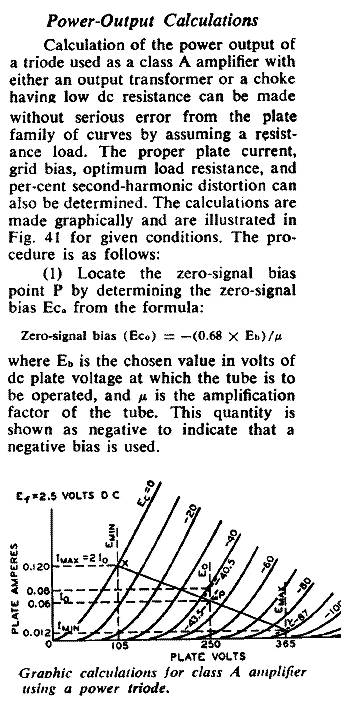

> I've never seen 0.6*Vp/Mu formula before, can you put some reference?
Every tube-dude "must" own a battered copy of RCA Receiving Tube Manual and know the contents of pages 15-50 (in RC30), "Electron Tube Applications". (PDFs are widely available.)
It isn't a full course in tube-use. Very hit-and-miss. But it is essential background knowledge.
> From basic theory Vp/Mu is the cut-off voltage of the valve, so 0.6*Vp/Mu is 'a bit colder than half-way'.
What he said. Except while voltage is 'a bit colder than half-way', the *current* will be pretty-nearly half-way (we hope).
What could go wrong?
What if two "authorities" give different factors?
I said 0.6. RCA says 0.68.

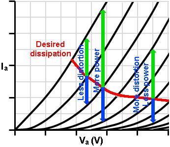

The general goal is to swing the tube from maximum current (zero grid) to zero current (ideally Vp/Mu). AND then the idle current is half-way between those extremes.
If tubes were perfectly linear, the grid voltage would be halfway. 0.5.
Tube Gm falls with current. We need more and more grid bias to get less and less current. To get "half-way" current we need more than "half-way" voltage. A number greater than 0.5.
If Child's Law is true, and the exponent were 1.5 (3/2), then instead of 0.5 we must use 0.63.
Real tubes violate Child's assumptions. They are non-linear more or less depending on non-Ideal details of practical geometry. The exponent can be 1.3 to nearly 2.
Using a "0.6" adjustment assumes the CL exponent is closer to 1.4.
Using a "0.68" adjustment assumes the CL exponent is closer to 1.7.
> It's not a precisely derived figure, just a good starting point to check you're not doing anything absurd.
Right. This is just initial pencil-work. We want a "good guess" to see if the bias requirement will be some awkward value, and to rough-in some approximate values. We could then plot on the published curves to check, though in many cases the curves are not quite right. Final proof will come in a breadboard or smoke-test.
