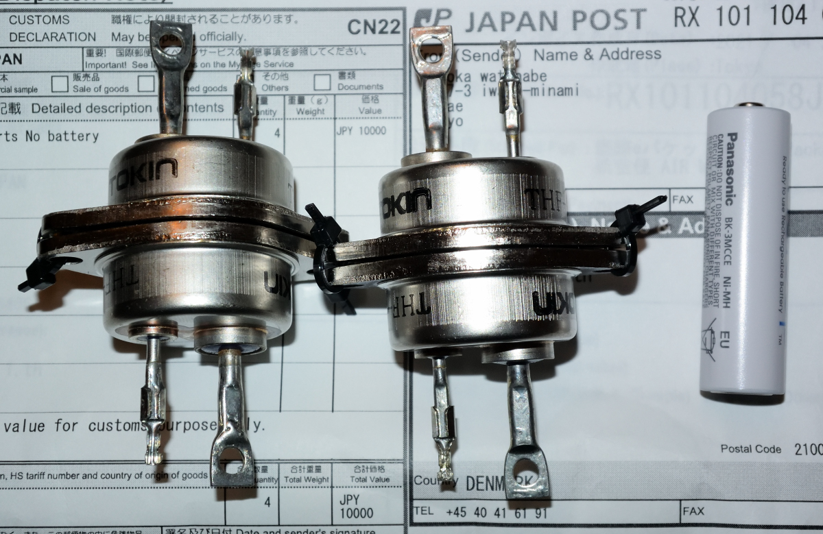

Got my random unmatched THF-51S pair from Tomoaki san.
Big pins a bit rusty but overall everything + package is top notch.
Tryed to curve trace with DCA75.
This tool is not for big transistors like this but this is what I have.

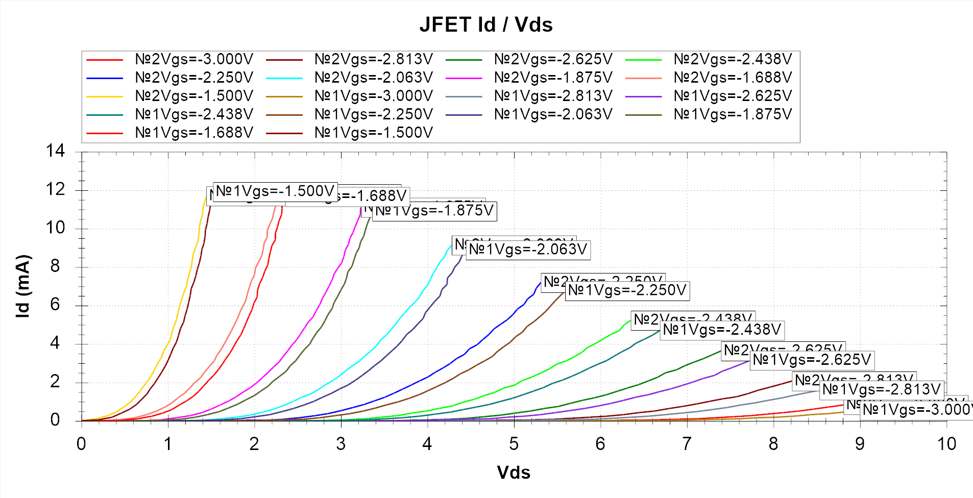

What DCA75 shows when I test them:
№1
N-Ch JFET
Vgs(off)=-3.30V at Id=5.0µA
Vgs(on)=-1.91V at Id=5.00mA
gfs=28.0mA/V at Id=3.0mA to 5.0mA
Idss>12.00mA at Vds=0.01V
Rds(on)<1.0Ω at Id=5.0mA and Vgs=0.0V
№2
N-Ch JFET
Vgs(off)=-3.36V at Id=5.0µA
Vgs(on)=-1.95V at Id=5.00mA
gfs=25.3mA/V at Id=3.0mA to 5.0mA

I would say those are fairly well matched parts!
I have a pair of similarly unmatched parts (THF-51S), and another pair of roughly matched parts. Currently buried in the first round of Sony VFET evaluation, but things are going really well so far. Much anticipation about what Papa has in store for the larger SITs.
I got these from "Tomo" and they looks nice.
Don't think they are mathed but will try DCR75 and check.
The AA-battery is just for size comparation.....as they are quite large transistors.

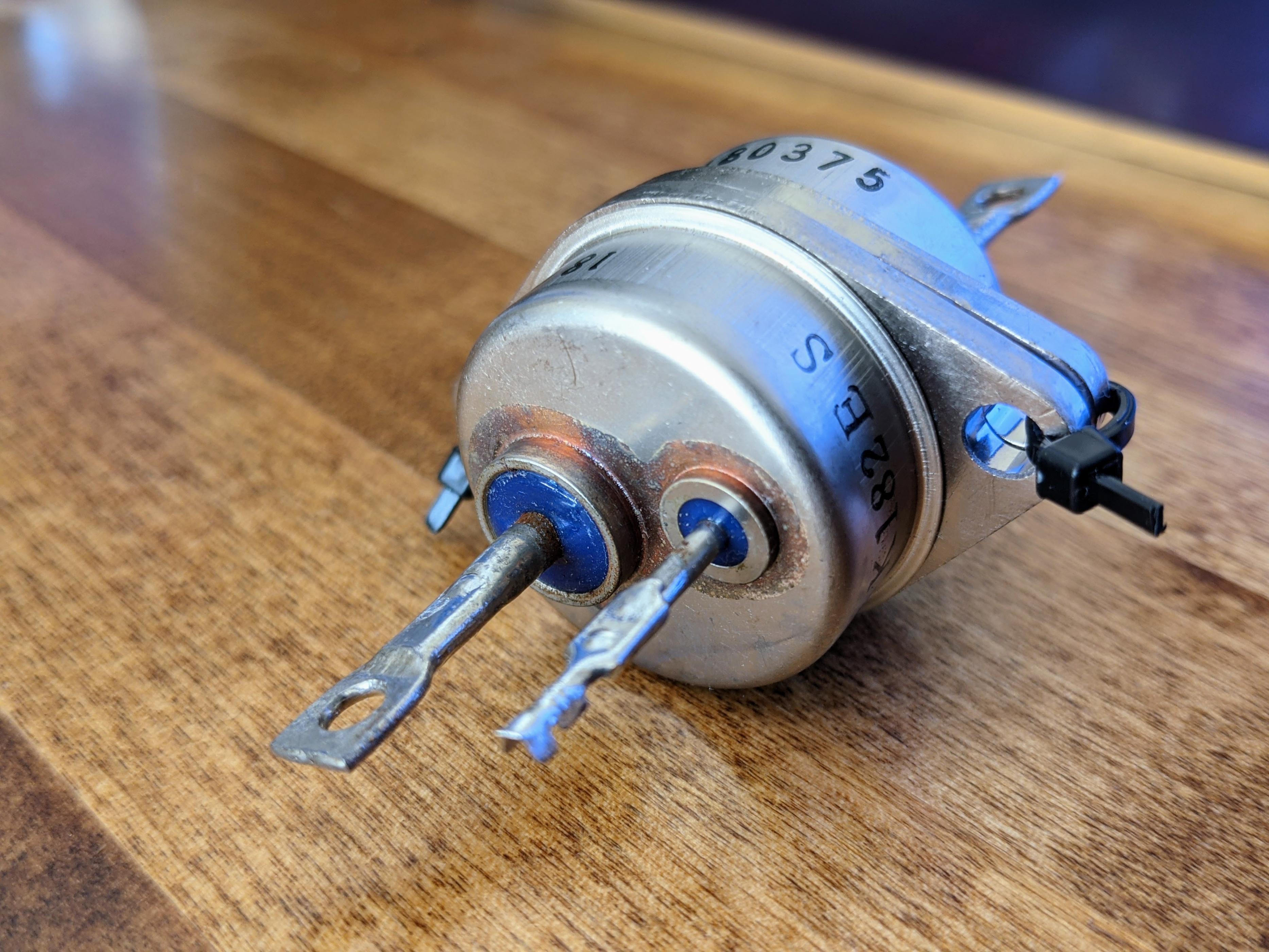

I've noticed several individuals mention cleaning their SITs. One of my 2SK182's could use some TLC, but I'm curious, is there any risk to just leaving them be? Is there a concern about the mica (the blue ring is mica, right?) not providing a proper seal?
