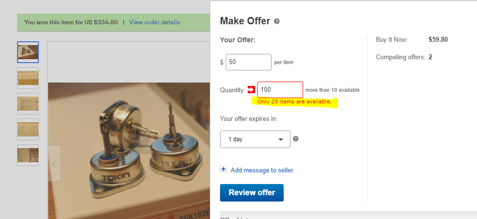

While they last...
Not to put pressure but....
