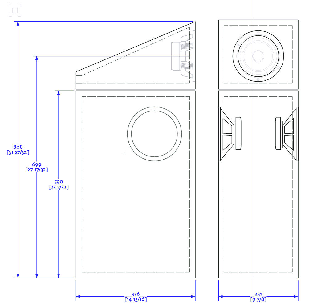

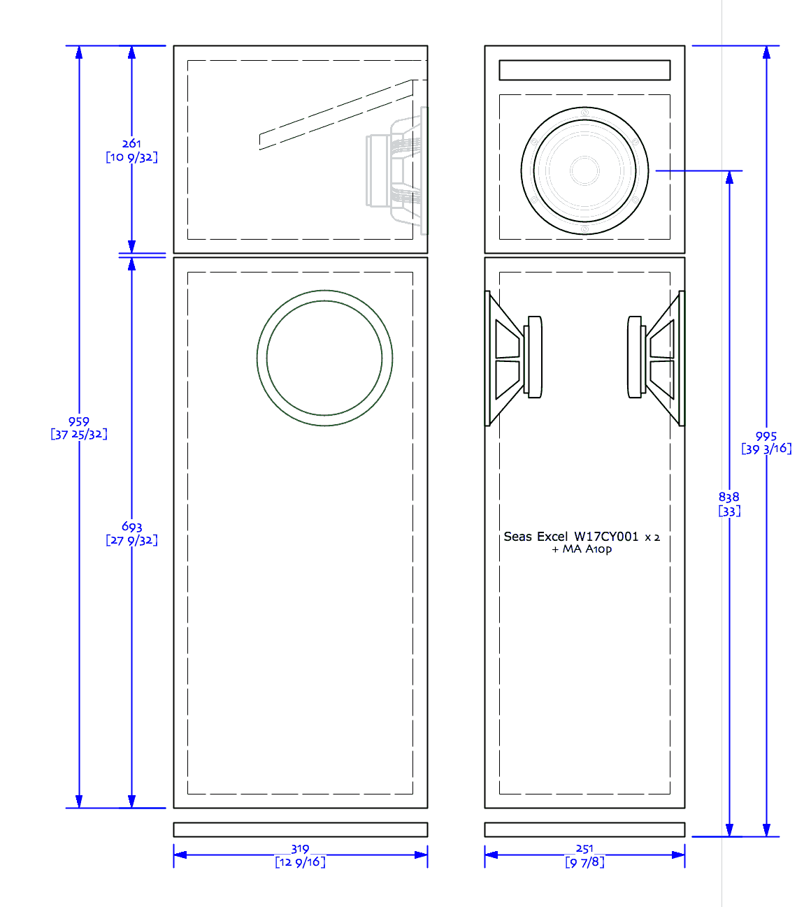

Here is a 1st pass. Near golden ratio bass enclosure. A10p in an aperiodic TL.
It is too low, one can give up enuff depth to push the height up the desired amount — you don’t want to go narrower for the sake of the A10p. Tha shortens the TL, but you probably want to fold the line into a rectangular box (terminus out the front).
attachment.php
So at a guess 250 wide x 1000 high by whatever the decrease in depth needed to account for the greater height.
Subs should go wherever they best counter room resonances. Within a 1/4 wavelength at 60 Hz (say a half metre).
dave

Thanks for the detailed drawings Dave!

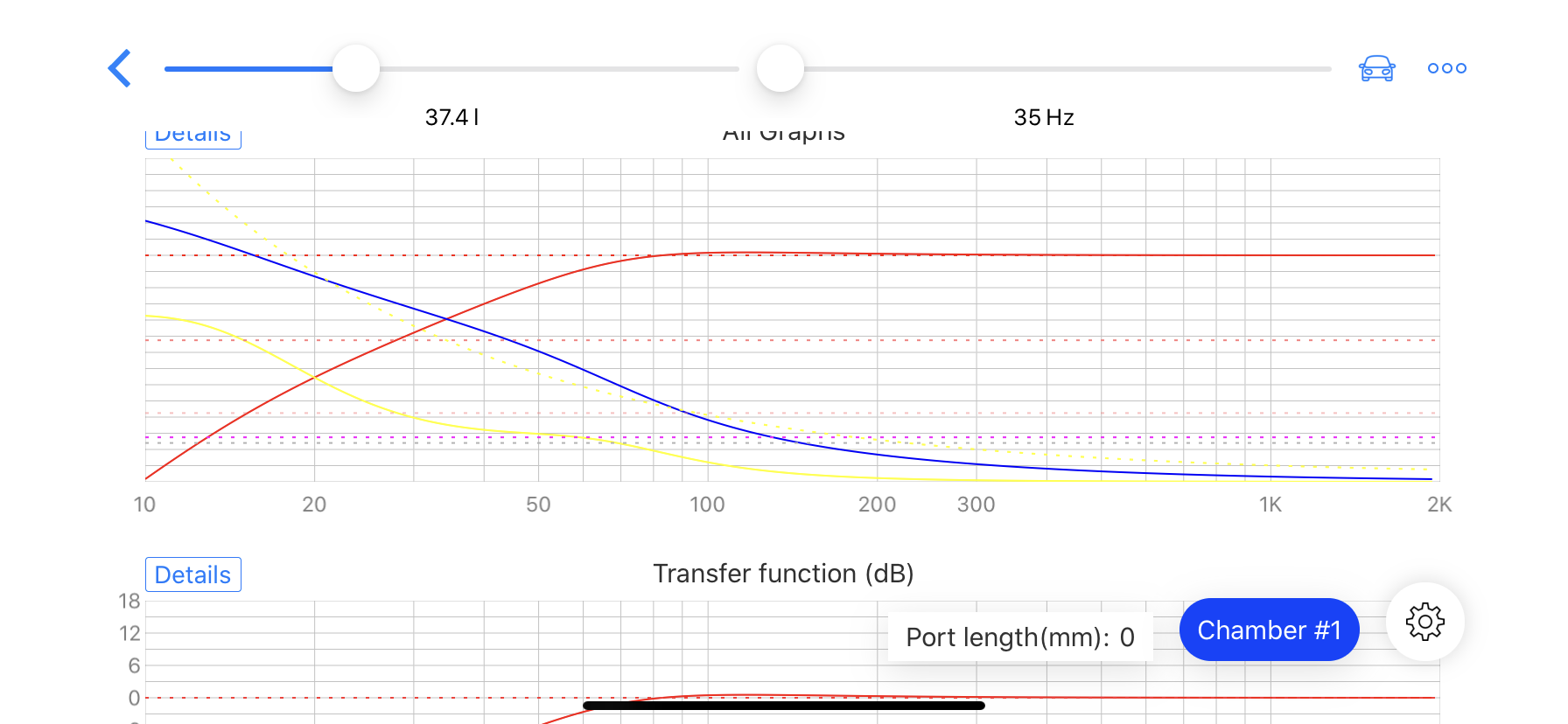

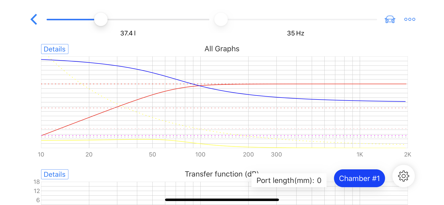

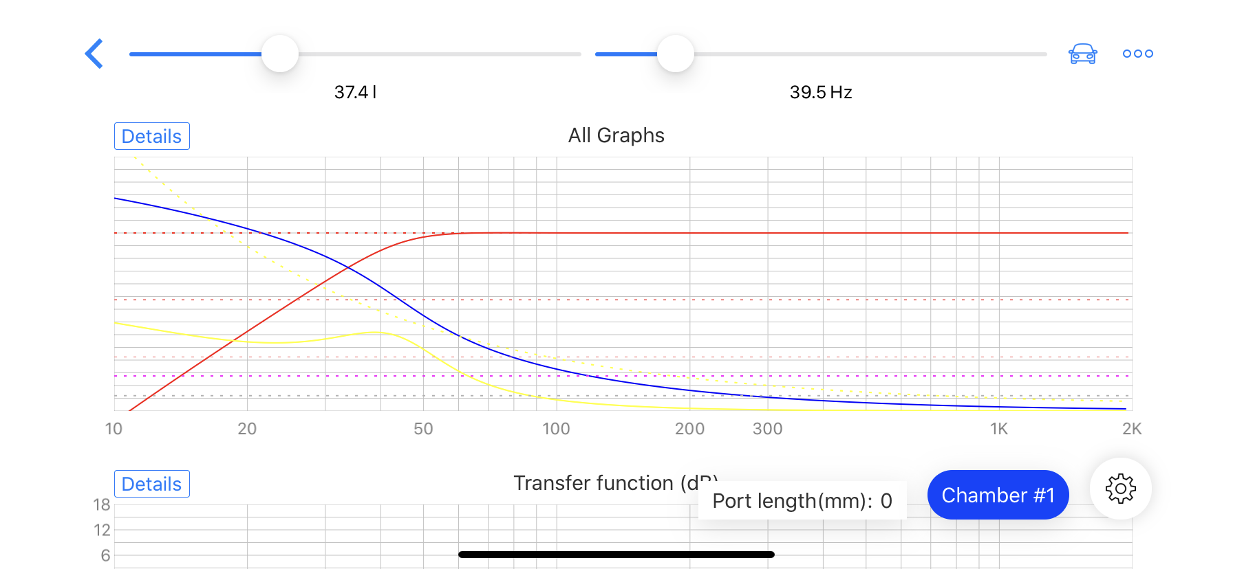

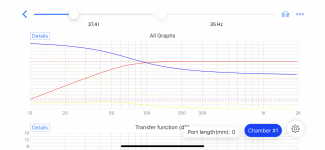

The Peerless 8” driver appears to fit into a reasonably small sealed enclosure, would it be possible to put a pair of those into the first drawing you posted, in place of the Seas Excel? ? I rather like the sloped top of the first diagram 🙂 mounting depth and internal enclosure. volume would work for dual sealed and also single or dual vented.
Peerless by Tymphany 830869 8" Nomex Cone HDS Woofer
Matt
1st pic single 8” vented
2nd pic dual 8” vented
3rd pic dual 8” sealed
