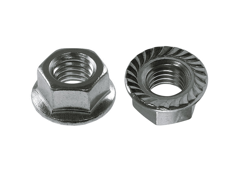

I would simply cast in a flange nut. The nut should be cast in closer to the inner surface of the enclosure where the flange goes inside of the compound. The flange will keep the nut always in the compound and also add more surface so the enclosure does not crack when tight mounting it to the stand.

Do you mean a plate of the same kind as this one?Get a plate with 1/2 UNC thread for the inside and cast around that.

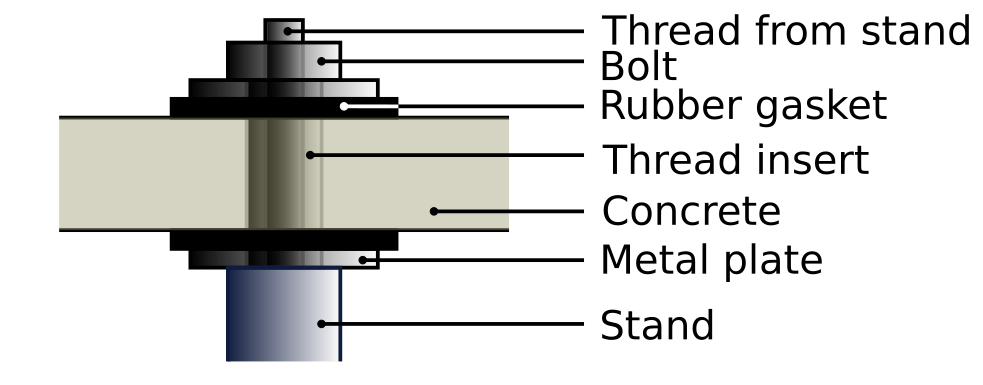

Concrete takes compression forces well, but not other types of loads.
I would tend to sandwich two plates together using bolts, and a rubber gasket on each side against the concrete material.

No just a piece of metal with an 1/2"UNC thread in it, like a square or round plate.
Something like this?

Please tell me if the representation in the attached diagram is correct (sorry, couldn't make it appear directly, don't know why). So, the metal places are sandwiched only. There's no other tie between them and the thread insert?
