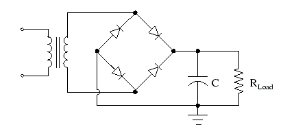

I want to build a new amplifier. I already have a 35+35 vac
10A transformer. I want to use it as 0-70vac. My circut operates on 70+70 vac. What you say about it
If you require 0/70 and have a 35/0/35, then the best way is a FWB,
with the windings in series, and one capacitor. Don't use the common center connection.
If you don't have capacitors of adequate voltage rating, then series connect two
electrolytic capacitors, with a parallel 10k resistor for each to balance the voltage division.
Please under stand my question.
My amp requierment 70-0-70. I have 35-0-35. If i use 1st loop as commom and last loop as 70v. And connect 70v to bridge rectfier both Ac. The out put will +&- 70v. Now can i use this in amplifier
If you need +70VDC/0/-70VDC, there is no simple way to get that from dual 35VAC windings.
Normally you would use series connected dual 50VAC windings and a full wave bridge for that.
Or do you mean that you actually need +35VDC/0/-35VDC instead?
This looks to me, a call to using a bridged output stage ( aka H drive ). One legs swings +35 /0/ -35 while the other leg swings in opposite phase -35/0/+35. So the loud speaker can get near 70v peak.Please under stand my question.
