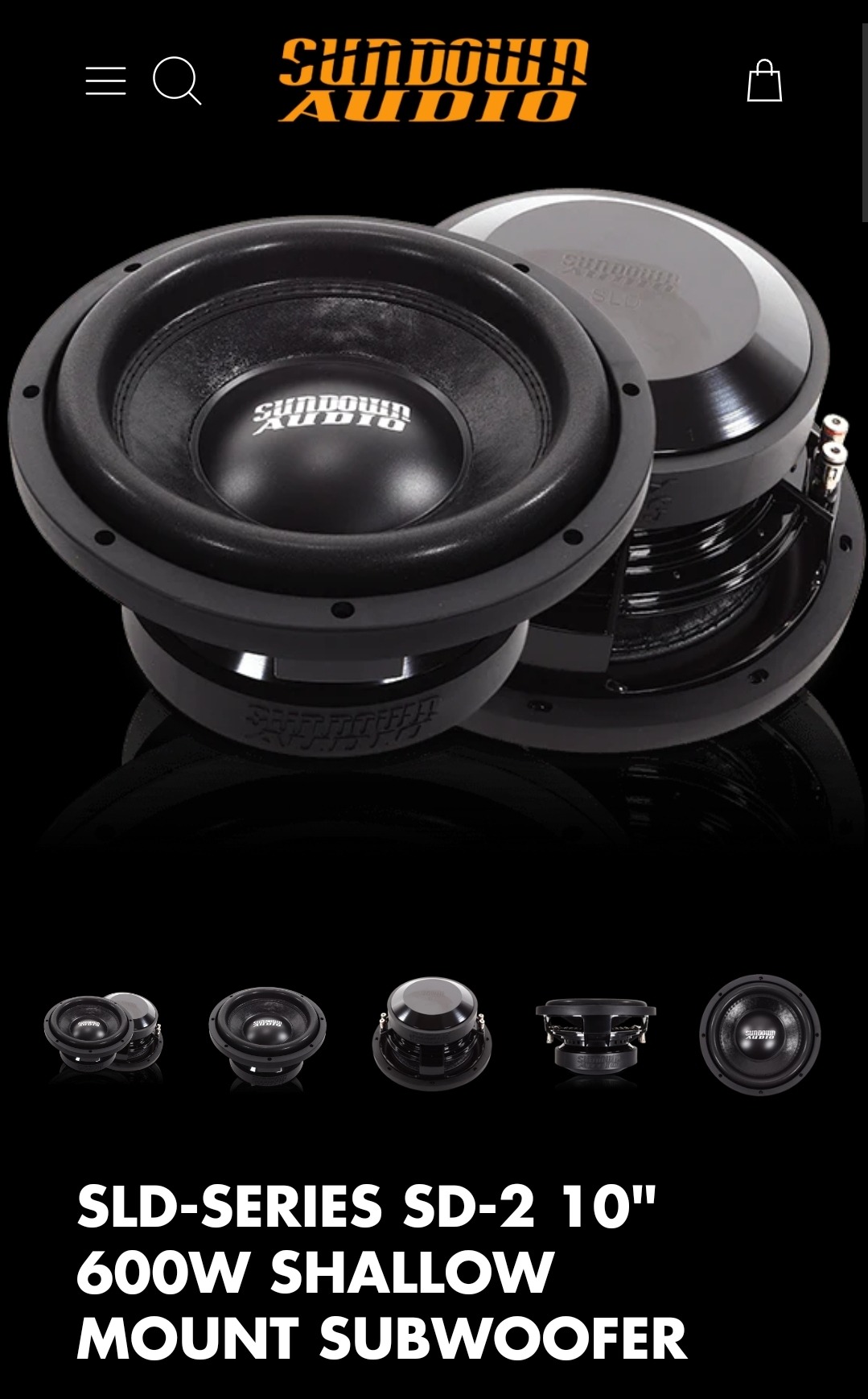

Which sub will (probably) be louder?
SLD 10 vs SD'4 10... Which will (probably) be louder in a sealed enclosure?
I'm putting in 2 10s, with 0.8 ft³ of airspace for each
SLD has higher sensitivity and BL but 2.5mm less excursion, with a qts below 0.4 and Vas of 0.51 ft³, ive been told with sub 0.4 qts that box should be below Vas, so my box might be too big? and the cone is deeper I don't know if that contributes to sound
SD4 has lower sensitivity and BL but more excursion, with a qts of 0.51 so from what I've heard the box should be above VAS, but VAS is 1.275 ft³. the sd4 has more excursion, and much lower Fs HZ, which I like the low bass.
So I'm not sure if either of these subs would be good for my setup, which should I go with?

0.8 = ~22.65 L/driver
Vb = Vas @ ~0.403 Qts'
(Qts'): (Qts) + any added series resistance (Rs)
So without knowing how high Qts' will be for each, then at a glance..........the SLD is ~3-3.5 dB more efficient, so the SD will need at least 2x more power handling that I presume it doesn't have, then factor in that the SLD's Vb/Vas ratio allows some significant Qts increase to fill out the too large box makes it by far the better choice overall to my way of thinking.
