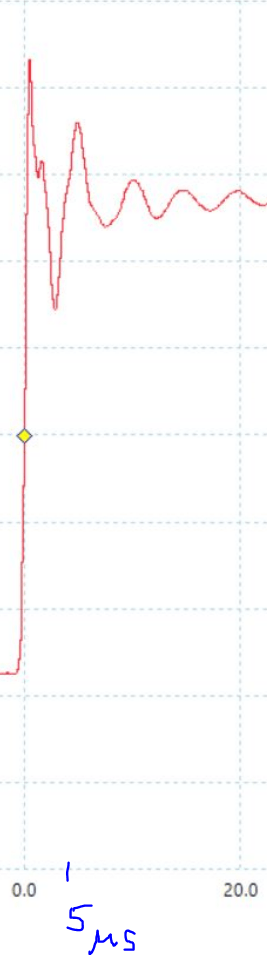

Sitting here rethinking my approach to this and am wondering if I should try cleaning up the ringing at the source, rather than fixing it with feedback? I am almost certain that the ringing is the output xfmr and in open loop testing the stages from input to output will reveal that the square wave is clean until it gets to the transformer. Perhaps a different approach to control the ringing is called for, i.e. clean it up at the source, damping resistors or small R/Cs around the transformer, then apply feedback without any or minimal C.

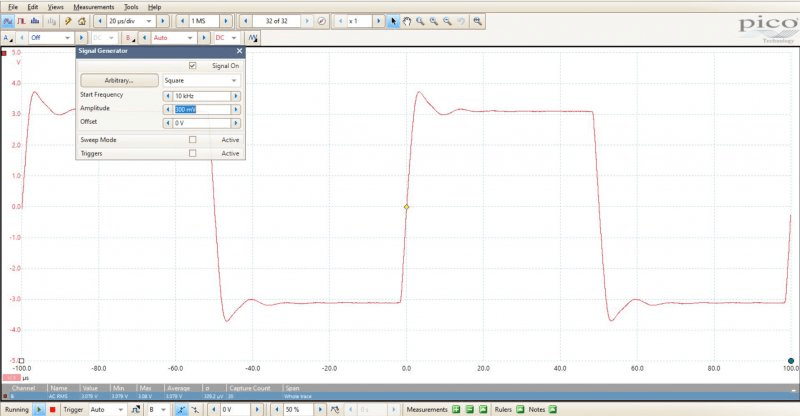

I think you're overthinking it. ;-) That is NOT a lot of ringing, the feedback is doing it's job, the top of the waveform is dead flat, so no oscillation in sight. Have you tried it with some capacitance across the fixed load? Try .1uF. If it doesn't disrupt the square wave much, the amp is very stable.

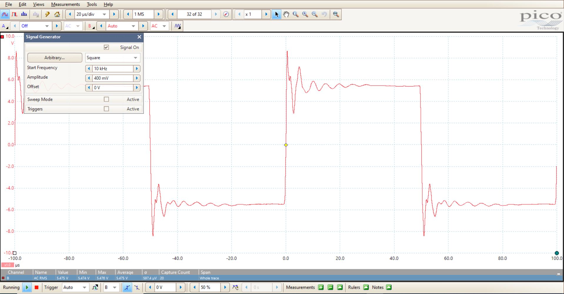

FYI, here's some ringing for you. ;-) That's an untamed Acro TO-330 in a stock Williamson circuit.
Is that the waveform at the output of that transformer?? If YES, that's a fast response capability... for a transformer... nice.
I was thinking exactly the same thing, so easy to tune that one.
I would like to know why my amp/xfmr seems to be so slow, rise/fall is terrible compared to the ACRO TO-330. Is it the xfmr, circuit or ?? I'm pretty sure it's the xfmr.

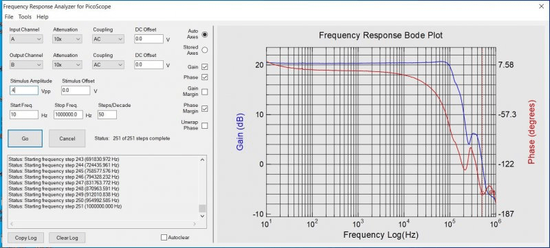

You don't want that waveform. That amp will oscillate if you breathe on it. ;-) It's partly the Acro and partly the feedback, but mostly the Acro. Amazing bandwidth but they're tough to tame. I can't find the Bode plot I did for that, but it's got ultrasonic peaks all over the place and multiple phase shifts. Below are pix of a Heyboer copy of the Peerless S-265-Q at 10kHz, almost exactly the same circuit, plus the Bode plot I ran. The difference is that this time it's stable even with some capacitance across the load. And there's no lack of HF response. There's a bit too much overshoot which I tamed with a slightly larger phase-lead cap, but you get the idea. You really don't want straight sides at 10kHz.

I use the 2204A, which was about $350. It's fine for DIY amps and such. The built-in signal generator goes up to 1mHz, which lets you check the supersonic response of a feedback amp. There's a third-party app for Windows you can find on the Picoscope site that can run a Bode plot and check for phase shifts, phase margin etc. Very handy.
Here's the app:
https://www.picotech.com/library/picoapp/frequency-response-analyzer-with-bode-plots
The only downside of the Picoscope is that the signal generator only puts out up to 2 volts. For testing for clipping, etc., I have a separate digital generator with higher output. But for the Bode plot app you need to use the Picoscope's internal generator. For testing at 1-20 watts output or so it's fine, depending on your amp's sensitivity, of course.
