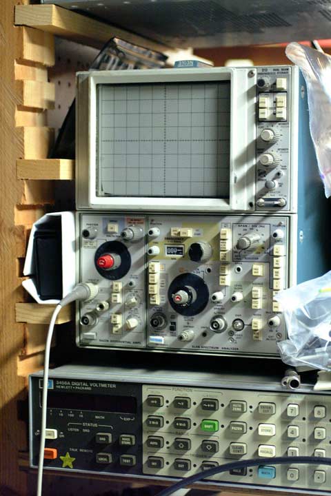

What is the better spectrum analyser to have?
A Tek 5L4N on a 5113 mainframe with a dynamic range of 80dB for $220
or
A software package such as SpectraPlus 132 for $300 or more with plug ins.
or
I prefer stand-aone gear. I can take it where I need it, without having to lug a computer.
Not familiar with that model, but I have had troubles with a Tek mainframe/analyser combo at my last job. Could have been a fluke, but it spent more time at Tek than my lab.

fmak said:What is the better spectrum analyser to have?
or
Whilst like Jocko I prefer standalone equipment, in this case the PC based solution is superior. You need to factor in the cost of a good soundcard and don't rely on some of the published numbers from the cheaper vendors. However, you can easily beat the 70dB spurious free dynamic range that the 5L4N provides. Unlike a spectrum analyser the inputs on a sound card are usually fixed level so a set of attenuators or amplifiers may be needed for some applications. The flexibility that a software packages can give you with a cheap soundcard is hard to match in the audio range unless you are willing to move up to much more expensive equipment.

There is a BIG difference between your two choices, fmak.
The Tek is a swept analyzer. The PC soundcard mit software
will be an FFT analyzer.
The two are not necessarily interchangable. Each has pros
and cons.
The Tek stuff can be flakey and IMO they never really figured
out how to make a spectrum analyzer, modular or one-piece.
But for $220...
If you're only wanting audio, look for an HP3580A.

BrianL said:There is a BIG difference between your two choices, fmak.
and cons.
But for $220...
Brian, saying that TEK never figured out how to make a spectrum analyzer somehow doesn't compute with the fact that they sell several million dollars worth every year and are the gold standard in certain TV, cable RF applications. We could find fault with Agilent, Anritsu, Rohde, Fluke etc. if we had the time.
The truth of the matter with respect to the 5L4N is that it isn't an easy instrument to adjust if it gets out of alignment. Don't bother with the 5L4N unless you get a manual and get some shots of the thing actually working. As with a lot of TEK scopes, there are several proprietary chips which are impossible to replace. The 5113 mainframe is pretty durable, has a big screen and is dirt cheap. There are a good number of plug-in's for the 5XXX series including the 5A22N which has 10uV/cm sensitivity. Bandwidth is limited. These instruments were mainly used in automotive vibration analysis and medical applications. The 5L4N shown below works fine, but took about an entire day to align (and I had to make an alignment jig!)
FWIW, I use an FFT analyzer for power supplies and a "wave analyzer" hooked up to a chart recorder for audio.

Thanks. For audio use. If it covers rf, then it is a bonus.
What are you looking to measure and for what purpose? Knowing that, it is likely that you can get more specific adivise.
My 2c, FFT is better, especially for audio. Only the practicalities of making a sufficiently fast A-D convertor with enought memory / computational speed limit the FFT technique.

I finally resolved my dilema and decided against another 10 kg instrument.
Found the dr-jordan-design WinMLSPro package on ebay for $25 and upgraded to 24/192 with 64 bit FFT.
Works nicely; an instrument with high dynamic range and zero additional weight!
