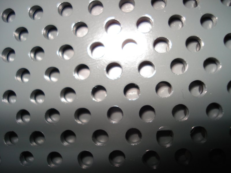

if a hole is just punched or routed or lasered) straight through the sheet such that the ´walls´ take the form of a cylinder, each of the small cylindrical holes will act as a tiny Helmholtz-resonator, ie like a bassreflex casing.
The bassreflex is a box-tuning with bandpass character. Dependant of the relations of hole number count, dimensions of the holes, and the enclosed air-volume between the stators the upper bandwidth limit could be as low as 10kHz. A narrowing or kind of double flare of the crossection of the hole´s shape reaches a much higher upper bandwidth. This is automatically the case with wires as well as thickly coated punched metal, but not the case with thin, or not at all coated PC-board and just punched (or routed or lasered) sheet metal stators. There are formulas to calculate the bandwidth limit, but to my experience these formuas are notv very precise. But at least they give You an idea if Your stator design has flaws regarding this point.

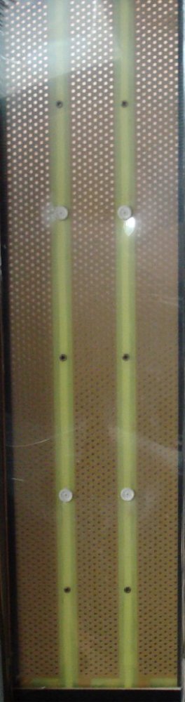

Hers is a pic of the newest quad , just to show the grid ( note this is not the stator, I'm showing the grid so most can see what we are talking about ) then picture it with a wired loop, of course you would use a much shallower grid pattern , what was typically used was about 1/4" or slightly less , of course this is dependent on wire size....
the distribution character of a panel is solely dependant on the physical dimensions. Refraction at the stator holes doesn´t play a role to this as far as I know. Stators with equal opening percentage tend to be sonically equal too, apart from the one with higher efficiency tending to sound more ´dynamic´.
Stators with high opening percentage surely don´t measure better, especially under higher power conditions, because of the greater inhomogenity of the electrical field. A smaller percentage of openness could even help to reduce the problem of the high Q of the base resonance a bit, which you have to tackle with additional mechanical or electrical damping.
Wayne, the way You use ´grid´ lets me assume, that we are talking about different things. The grid, that can be seen in the Quad-picture just has the function to mechanically stabilize the stator plates, which in this case are kind of PCB-style. The openness of a stator has basically nothing to do with this ´supporting structure´. The panel could even work completely without it.

From your picture, I can't see very well what kind of stator they are using. The outside grids look to be just a supporting structure of the stator.
Wachara C.
Hello ,
If you read my post again you will see where i had said it was just a support structure for the speaker grille.
The picture was posted to show the egg crate look,of an open stator, as this is what i was alluding to when i had mentioned an open wired stator ... the one in the pic is not the stator .

The smart thing about PCB-material is, that it can easily be designed with CAD-programs and could be premanufactured with good precision. The electrical characteristics of FR4-base material are very competitive to other insulative materials and the stators would be quite safe. Electrical segmentation is possible.
The best solution would be to have the copper layer encapsulated between two base-layers as it is written in R.Sanders patent (btw. could anyone tell me what is new with this patent? The described techniques are sota for at least 30years!!). You won´t need any more coating but solely for optical reasons. So it´d be good to have the hole´s shapes fabricated with taperings or roundings. For example routed with a special tool of appropiate form.
Quad used just single sided base material and coated it with insulative laquer. Here a functional and thick coating is necessary.
The bandwidth problem depends on several parameters:
- enclosed air volume of the stators
- number of holes
- diameter of holes, or dimensions of the openings if its not a circular hole
- length of the hole, i.e. thickness of the stator sheet
- crossectional shape of the holes
The trick is, that the air within the hole shouldn´t behave like a small piston. A non-cylindre-crossection is good, like trapezoid or flared, double-flared or rounded. If you can´t provide for such a shape the ´length´ of the cylindre, i.e. the thicknes of the sheet, should be smaller than the hole´s diameter. So larger holes allow for thicker sheets, while smaller holes ask for thinner sheets.
