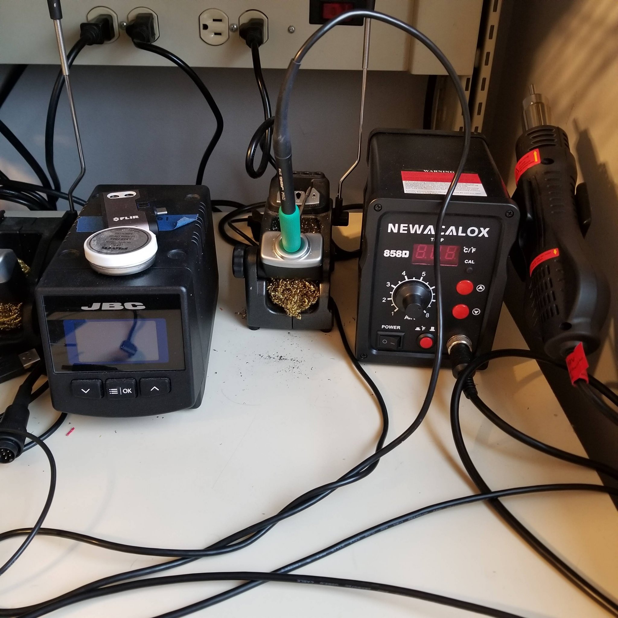

The auto-off feature saves soldering tips. With the higher temperature solder, and the need for hotter tips, those tips oxidize very fast. Now tips last a very long time. When I say "auto-off", what's really going on is the iron cools down to some low temperature. When the iron is in its cradle, it cools off very quickly. As soon as the iron is out of the cradle, it heats up in about 2 seconds or so. Nice, right?
If the photo comes through - you can see my soldering station (JBC). I've got tip cleaner there, but I almost never use it. On the right is the cheapo, but actually pretty decent hot-air station.
