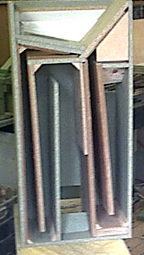

Saxophon
for such a large room,
the saxophon might be good,
free download plan, measurements,
extrem cheap by using the BG20 Visaton invers.
http://www.hm-moreart.de/102.htm
Translation ?
http://translate.google.com/translate_t
